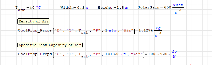

I'm putting together a sheet using the CoolProp wrapper
It generally works really well except for the following
Where I'm getting strange units for the Specific Heat capacity of Air
I've tried overriding the units but still don't get what I want (J/kg/K)
I've attached an extract from the sheet --> UnitsProblem.sm (7,04 КиБ) скачан 1377 раз(а).

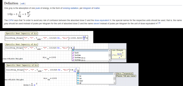

Can't reproduce. J/(kg*K) works. Paste 'J/{'kg*'K} to the square placeholder to the right of the unit when the region has focus.

#3 Опубликовано: 01.08.2017 17:05:37
Can't reproduce either "Units don't match",
because there is NO heat capacity unit in Smath.
Peter J Francis 02.08.2017 05:18:00

You just have to change the units.

Thanks All,
You are all correct (I knew the answer was going to be obvious ) , pasting in the units J/kg K works fine
Its just that Gy/K seems an odd default unit
Thanks for your help
