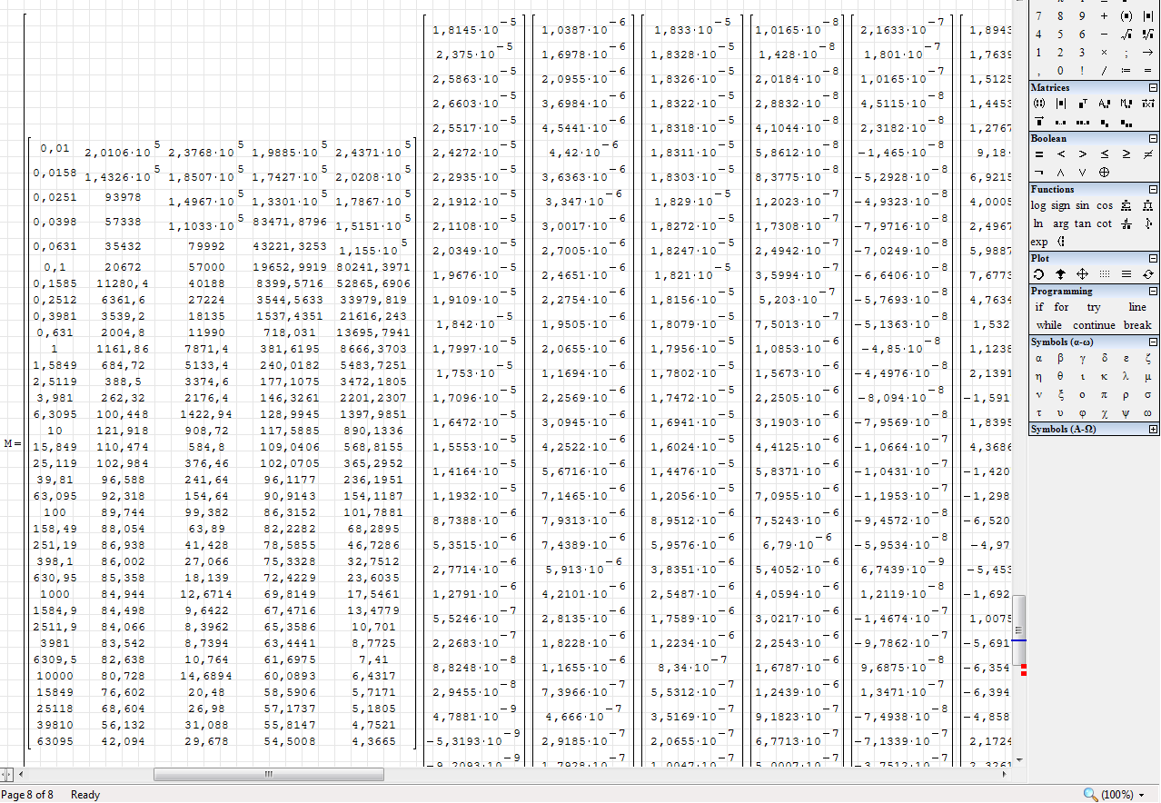

The matrix I write is pretty big but here is what it looks like when I want to show it:
The number of lines matches.

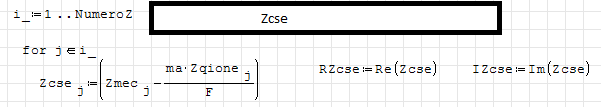

It is created via a succession of augment() of columns made of real and imaginary parts of complex arrays that are created line by line in a for loop, example for one of them here:

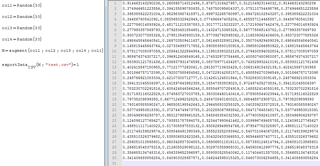

WroteIf I remove the " " and try to read it with rfile it gives the value 0.
Your collection is not a matrix; it is an MDA [Multi Dimensional Array => Matlab]
or a CELL ARRAY [Mathematica]. No matter, the "collection" can be spooled to file
and recalled from file, just do it the right way as exemplified [attached].
File Create.sm (24,67 КиБ) скачан 1260 раз(а).
... you can't remove the quotes "..."
