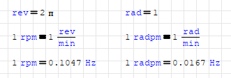

It seems that this issue from 10 years ago has resurfaced (I'm using version 0.99 Build 7822 on 64-bit Windows 10). I'm responding to this long dead thread, since this is clearly the same problem as before, and a Google search didn't find any other similar problems).
SMath (erroneously) produces:
1 rpm = 0.1047 Hz (= 2π/60 Hz)
1 radpm = 0.0167 Hz (= 1/60 Hz)
2π Hz = 60 rpm (= 1 rev/s)
2π rad/s = 6.2832 Hz (= 2π Hz)
Doing a manual unit conversion (paper method) reveals that the above values are wrong:
1 rpm = 1 rev/min * (1 min)/(60 s) = 1/60 * rev/s = 0.0167 Hz ====> (NOT: 0.1047 Hz)
1 radpm = 1 rad/min * (1 min)/(60 s) * (1 rev)/(2π rad) = 0.00265 Hz = 1/(60*2π) Hz = 1/(120π) Hz ====> (NOT: 0.0167 Hz)
2π Hz = 2π cycle/s = 2π rev/s * (60 s)/(1 min) = 2π*60 rev/min = 120π rpm = 376.99 rpm ====> (NOT: 60 rpm)
2π rad/s = 2π rad/s * (1 rev)/(2π rad) = 1 rev/s = 1 Hz ====> (NOT: 2π Hz)
Oddly, SMath does have the units right for both rev|rad and min|s:
1 rev = 6.2832 rad = 2π rad
1 rad = 0.1592 rev = 1/(2π) rev
1 min = 60 s
1 s = 0.0167 min
But as soon as they're combined with time, SMath manages to mess up the calculation:
1 Hz = 1 rad/s ====> (should be) ====> 2π rad/s
1 rev/min = 1 rpm = 0.1047 Hz ====> (should be) ====> 1 rev/min = 0.0167 Hz
1 rad/min = 1 radpm = 0.0167 Hz = 1/(60 s) = 1/60 s^-1 ====> (should be) ====> (1/60 rad/s OR (1 rad)/(60 s) --- maweilian's proposal about radpm incorrect... what he said should be applied to rpm, NOT radpm).
One rev/cycle/rotation is basically the "real" unitless value. Everything else is defined therefrom: 1 rotation = 1 cycle = 1 revolution = 360° = 2π rad = 4 quarters, etc.
Since Hz is defined as "one cycle per second" (1/s), it is a unit of frequency. rpm is a unit of angular *frequency*, while radpm is a unit of angular *velocity*. Therefore, rpm should be defined in terms of 1/s, or "cycles per unit time" while radpm should be defined in terms of rad/s, or "radians per unit time". In other words, radians [rad] are defined with respect to cycles [] by:
1 [] = 2π [rad] ===> [rad] = 1/(2π) []
Making rpm and radpm defined with respect to frequency ([Hz] = []/[s]):
rpm = [rev]/[min] = []/[min] * (1 [min])/(60 [s]) = 1/60 []/[s] = 1/60 [Hz]
radpm = [rad]/[min] * (1 [])/(2π [rad]) * (1 [min])/(60 [s]) = 1/(2π*60) []/[s] = 1/(120π) [Hz]
