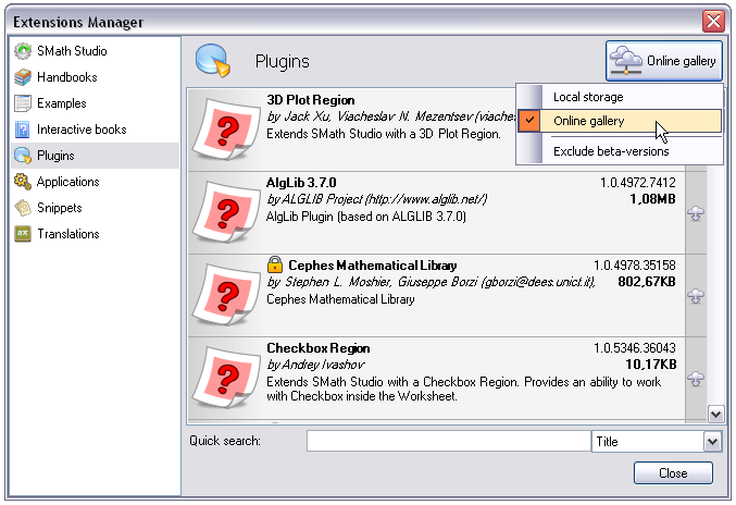

Hi all - Apologies that this isn't under the Extensions forum, but that forum appears to be for developers and this is a very ignorant noobie question:
I want to install a single custom plugin. I'm working a network machine, on which I don't have admin privileges, so installing TortoiseSVN (or any new software) is not an option. Is there a simple workaround for installing Plugins? For example, can I simply copy the dll (and other files?), drop them in a folder on my computer, then reference them from the Extensions Manager?
Thanks in advance,
Brett
#2 Опубликовано: 02.04.2015 07:24:12
If SMath is installed in your system, you should be able to install any extension even without system permissions.
Go to "Tools" > "Plugins..." > "Online Gallery" and download the plugins you need. They will be installed in the %APPDATA% folder (C:\Users\\AppData\Roaming\SMath Studio in windows 7).
If you have big permissions issues it is possible to use a portable version (here one)
