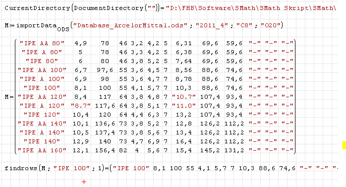

Thank you martin. You have been very helpful.
Do you think this excel file is too big? I was not able to reach the end of the calculation time.
See attached
Steel Properties.zip (1,18 МиБ) скачан 525 раз(а).
See attached

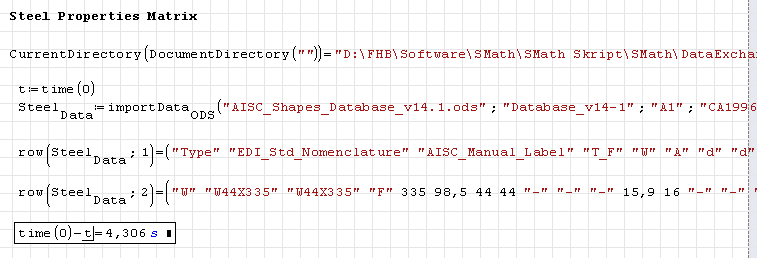

Just change the optimization (right mouse button menu) to numeric. Then reading in the sheet takes 4 seconds on my computer.
