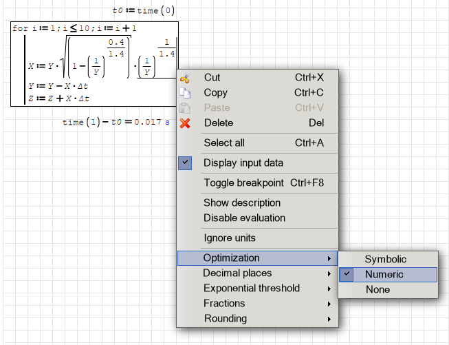

I'm trying to set up an iterative procedure for solving an integral equation, but I cannot see any solution. I've tried to use a FOR cycle as well as a WHILE cycle. With both I can only see the end of the cycle if everything is set up for at most 4 iterations. Anything that involves more than 4 will result in the cycle to take an unreasonable amount of time (not proportional to the time it took for the first 4 iterations). For 4 iterations in takes less than a second, if a set up 6 iterations it takes 40 seconds (10 iterations, is 7 minutes and still counting). Please consider that I need to iterate the cycle for at least 10.000 steps.

Right click to for loop.
Change Optimization to Numeric.
This had speed it to 0.017s on my pc.

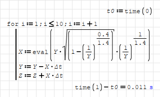

There is also eval() option.
It stores numerical value of calculation.
Without changing optimization to numeric;
sometimes it makes loops faster too.
