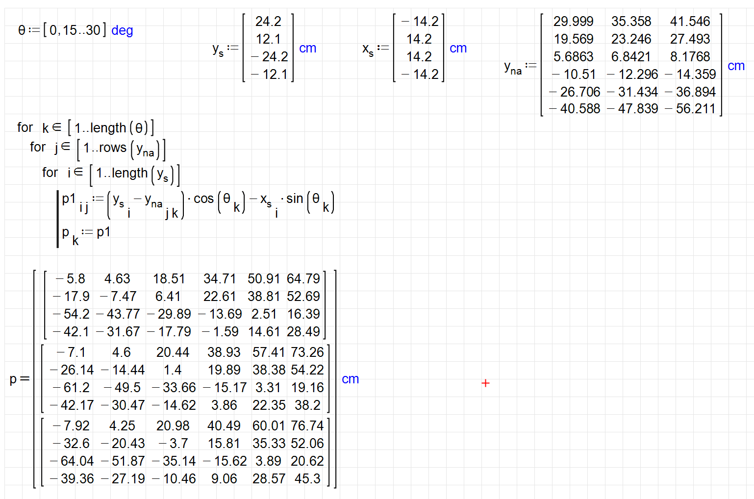

I am trying to create a matrix inside a matrix using a for loop.
This is what I did:
Matrix inside a matrix.sm (12,42 КиБ) скачан 1267 раз(а).
This works but my real data is much larger than the one in this example and it takes like 10 minutes to run. Is there a more efficient way to do this?
Your example runs in 0.5 s [Steam Engine Win 7]

Two things. One move the assignment of p[k to under the k for loop. You're reassigning to p too often. Also, for large datasets, it helps to initialize the size of the matrix rather than just increasing the size over each iteration. See attaached. Matrix inside a matrix_lyles.sm (15,1 КиБ) скачан 1279 раз(а).

Hola Pedro. Please check this version and tell us how long it takes with your data.
Matrix inside a matrix.sm (31,03 КиБ) скачан 1277 раз(а).

On my Win 7 ... takes 4 times my original SS 6179 doctored version.

Timing is about twice my doctored version.

Thanks a lot, this works perfectly

... annotated attachment ...Cheers ... Jean
