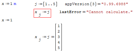

if x is 1m, the loop fails, if x=1, it succeeds. Any idea, what is going on? How to explain?

#3 Опубликовано: 25.02.2019 16:17:36
vectorize also works independently of previous values of x. It is just the above example of implicit loops. I am not searching for alternatives but want to have robust implicit loops. They contribute to readable documents. Closer to pencil and paper handcalc than to algorithmic pseudocode.

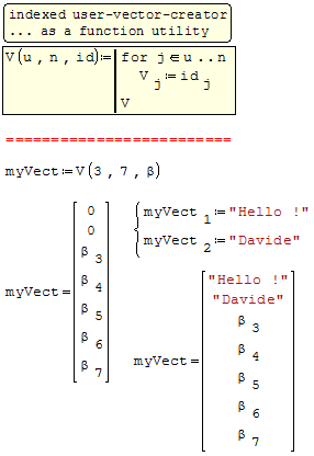

Hi. THis also fails too. Actually, it is a short form for the function NameVec in mathcad.

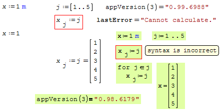

#8 Опубликовано: 25.02.2019 20:04:02
I'd vote for a better error message. In the given case, "Cannot calculate" will leave most users in frustration and dispair.
"can not calculate" because "syntax error"
"can not calculate" also appears in 6179 and 5346
resulting from more than a single "syntax error"
There's no indexing in your LHS; the syntax you were looking for is the following:
"can not calculate" also appears in 6179 and 5346 resulting from more than a single "syntax error"
This is because implicit assignment loops by vectors are available since SMath Studio 0.99.6638, in previous versions it's invalid syntax.
Oh, yes, thanks. That's correct.
