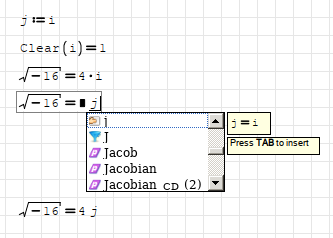

#3 Опубликовано: 10.03.2023 15:33:00
You can't totally remove i assign.
Or swap i with j via editing Constants.xml.
It is hard-embedded to smath code.
Clear(i) gives 1, which falsely results as it worked.
But it won't actually be removed by Clear().
However, you can assign sqrt(-1) or i to j.
Results placeholder can be edited with j.
And you can reassign you i result to j.
#4 Опубликовано: 10.03.2023 17:31:59

#5 Опубликовано: 10.03.2023 19:34:36
Am I understanding correctly then that there isn't a real way to assign lower case i as a normal variable and use it for a real number then ?
Here, 'i' is scalar wild real.
#6 Опубликовано: 10.03.2023 19:39:56
Thanks for the assistance! Am I understanding correctly then that there isn't a real way to assign lower case i as a normal variable and use it for a real number then? Just double checking.
Actually you can, but j won't constantly swap with i.
Every worksheet should have j:sqrt(-1) at top.
i will have what you assigned. variable, real, etc.
But when you calculate something which results as sqrt(-1),
it will considered as i again.
While i still has another value,
calculation still gives it as sqrt(-1).
But when you directly call i,
it will have what you assigned.

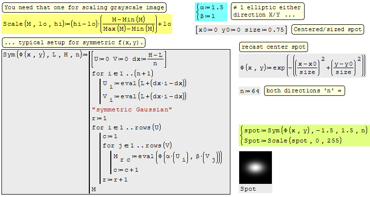

#8 Опубликовано: 12.03.2023 19:33:26
Imaginary 'i' is pretty universal.
Very many Smath advanced functions are coded on that basis.
They will certainly not recognize 'j' ...
As well, 'i,j' are largely used by Smath original Designers
and the Smath Community as rows/cols indices.

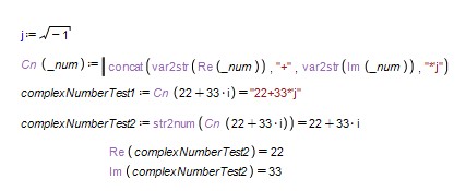

As for the second part:
... j to represent the imaginary unit...
As stated, you cannot replace 'i' as the Special Variable. However, there are some trick you can use (depending on your purposes):
First: define 'j as the imaginary unit; copy and paste the following:
Цитата
'j:sqrt(-1)
Next: define a function, similiar to this:
Cn(_num):line(concat(var2str(Re(_num)),"\002B\",var2str(Im(_num)),"\002A\\0027\j",1,1)
With this defined at the top of your sheet, you can display your number (as a string) in the syntax you desire. To use it as a mathematical expression, just use the str2num() function to convert it into math. NOTE: for this to 'work,' you need to have the 'Custom Functions' plugin installed:
May this be of Good Help!
- Kenny Lemens, P.E. ᵂᴵ
