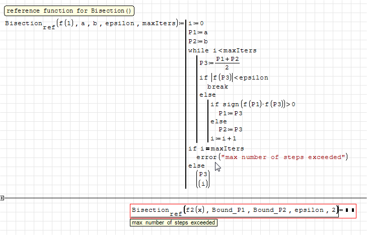

Hi everybody,
Please, are there some examples for the use of error function ?
Ioan
#2 Опубликовано: 08.09.2012 15:55:07
Hi everybody,
Ioan
See the attachment
regards,
w3b5urf3r
EDIT: new wiki page for error added
