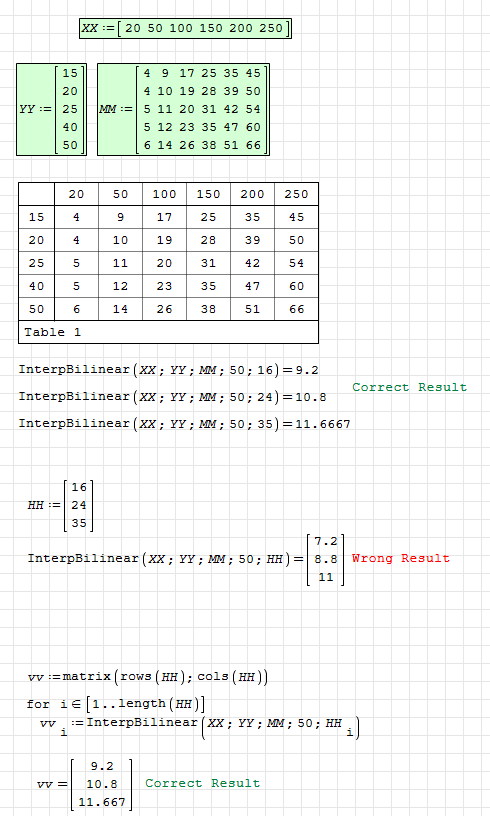

First of all I don't know if this method is supported, it would be very useful if not.
So if this is not a feature please forgive me because I considered as a bug.
The "InterBilinear" function gives wrong results if matrix is used for x or y value.
interpolation.sm (15,61 КиБ) скачан 1213 раз(а).

It is a bug, thank you! 4th and 5th argument type isn't checked, therefore (unintentionally) vector math applies.

Two things here:
1. The 4th and 5th arguments are presented in reverse order compared to Mathcad
2. The two dimension spline coding is from unknown source
...neither from either Smath [linterp, cinterp, ainterp]
...could be from erroneous quadratic source code.
As given in the attached: Spline(x,y,M) assumed = Mathcad Bicubic2D(x,y,M,vx,object)
At this point, you can spline/plot/rotate the surface as suggested before
Bilinear SplineInterp [Construct USER].sm (24,61 КиБ) скачан 1014 раз(а).
#8 Опубликовано: 05.07.2019 13:31:12
Two things here:
InterpBilinear(vx,vy,M,object,vector) ... does not collect"vector wise"
InterpBilinear(vx,vy,M,object,valueX) ... correct
That is the answer to the "bug",
