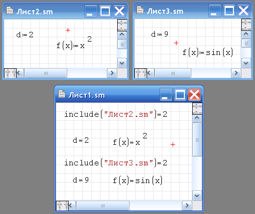

For me it's enough interesting if we can include already build functions form various individual files, for avoiding copy/paste or snipets.
My simply question is if there are in such cases some invisible "collisions" risks, by the use of many "included" functions in a file.
It is necessary to avoid recursion. I still can't catch this type of error in all cases. The only thing to keep in mind - it is the replacement of definitions. But I think this is normal behavior. Or you can suggest the rules how to resolve such kind of collision.

The error in the comboboxlist (or other controls plugins) shouldn't be triggered anymore.
include has a lot of potential, being able to run several worksheets at once from a single worksheet (as stated by you, a sort of improved snippet); the possible collisions (if you don't know the limits):
1) regions with an output to the canvas are not managed -> you may expect values are processed by the regions in the included worksheets, this doesn't happens;
2) there's not a check on the dependancies -> running the worksheets on another system you may miss the required plugins or (in the worst case) a different function with the same name of another (from another plugin not available in the source system) may be incidentally used with unpredictable results.
Вячеслав Мезенцев 02.03.2016 16:02:00, ioan92 02.03.2016 16:17:00

Yes, Davide is right, I forgot about the dependencies. Other worksheets are calculated in the current document environment. This is an important point.

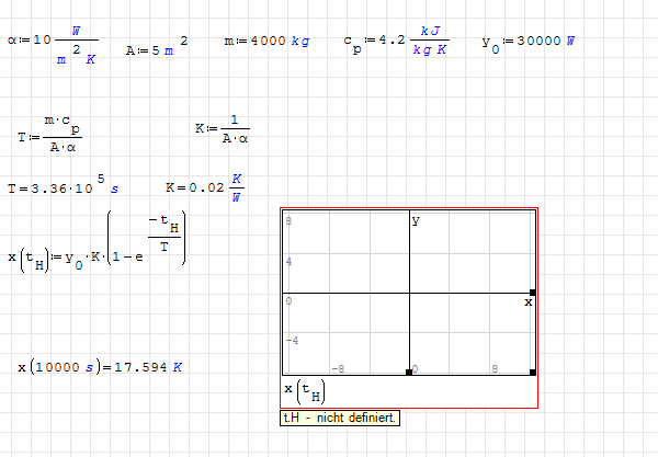

Lerch
Lerch
Hi all
2D Plot does not work with units
I tried to plot a function according the instruction of Sebastian Schluricke shown at www.youtube.com/watch?v=AtICkHXHFpk
His example I could easily do. But as soon if I go over to my calculations where I work with units I cannot plot them. I receive only the message variable not defined.
What is wrong here?
Kind regards
Gaselhul

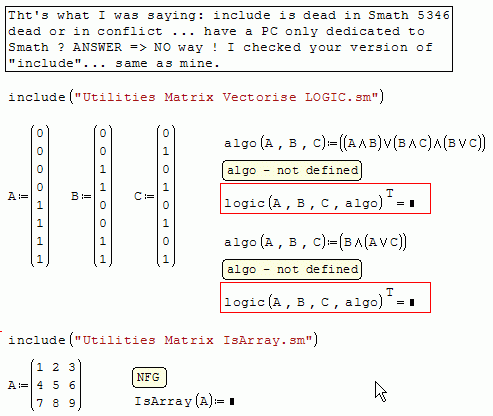

#17 Опубликовано: 03.03.2016 13:02:21
Salut Ioan,
I most appreciate your convincing demo.
Happy users if "include" 5346 works for you.
Dead for me, I don't care much.
Now: plugin & plugin ... as an individual user
fine as Smath a permanent "beta version". For
clients [remote clients] ... NO way to update
day by day as plugins arrive and often not
fully proven [not a critic].
Smath is like Mathcad was: you need a huge tool
box to fully exploit. Several hundred of tools.
At this point, a list of tools is needed and
must be updated ... something like Matlab
10 km long. Personal tools may be at risk !
My hart for Smath abounds for more essential
functionalities [clipboard ...] and more maths
[fft, integration, ... the list is long]
Most interesting is like this:
If Samth users find my Smath tool box profitable
to "include", it's possible to collect, will take
quite a while to group ~ 150 work sheets with minmum
application examples ... just going back to Smath
repository that was not so much welcomed.
Maybe Smath does not want to become a winner like
Mathcad 8 Pro. did.
Cheers to all, Jean
