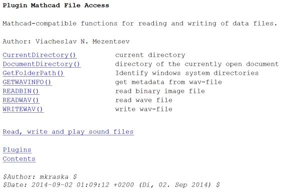

Hi. You can see the Document Directory with the Mathcad Plugin, not in the toolbar but in the SMath document:
