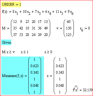

Is there in SMath some tools (plugin) as Given...Minimize/Maximize in Mathcad?

Greetings,
The Plugin is called 「Custom Functions」 by Davide Carpi; there you have Min() and Max() as they behave in Mathcad.

Is there in SMath some tools (plugin) as Given...Minimize/Maximize in Mathcad ?
I think something like this is a RemToDo in Smath
Hi. Also you can see Lagrange multipliers with Draghilev's method and Mathcad solve blocks here: https://en.smath.com/forum/yaf_postsm80940_Mathcad-Toolbox.aspx#post80940
