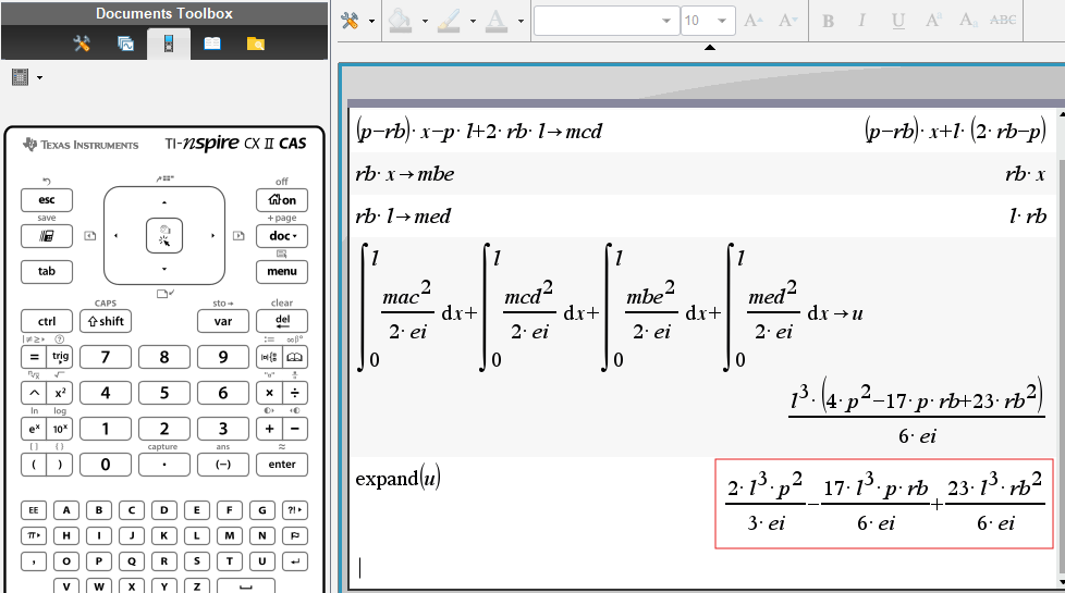

Hi. I'm using Ti Nspire cx cas. And I knew this wonderful smath studio program!
In Ti Nspire, when I want to expand a equation, I use expand() function.
But in smath studio, I couldn't find expand() function.
How can I do this, for example, the equation is
(x+y+z)^6

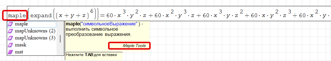

One way is to use the maple() function (MapleTools plugin).

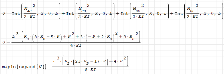

Thank you very much. I could expand my equation like below.
one more question please..
Can I expand it in smath studio like in my Ti nspire result?

Maybe, you just have to switch Optimization> None in the context menu. SMath's symbolic "optimization" sometimes rolls back external expansion with Maple or Maxima.

Thank you, Вячеслав Мезенцев & Martin Kraska.
I count get the same result by your way.
The solution was "optimizaion>None"!!
