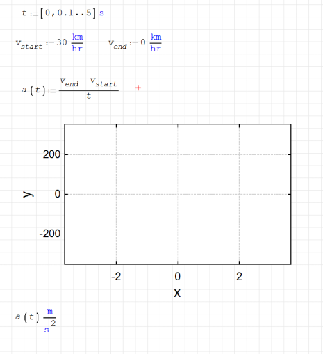

Hi All,
Could you direct me how to plot the function for some range?

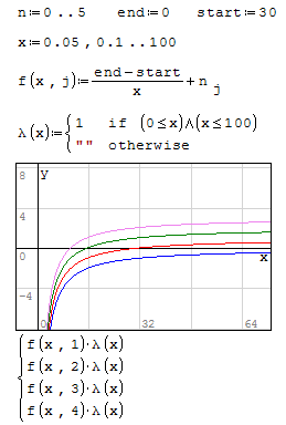

X_Y plots f(x,y)

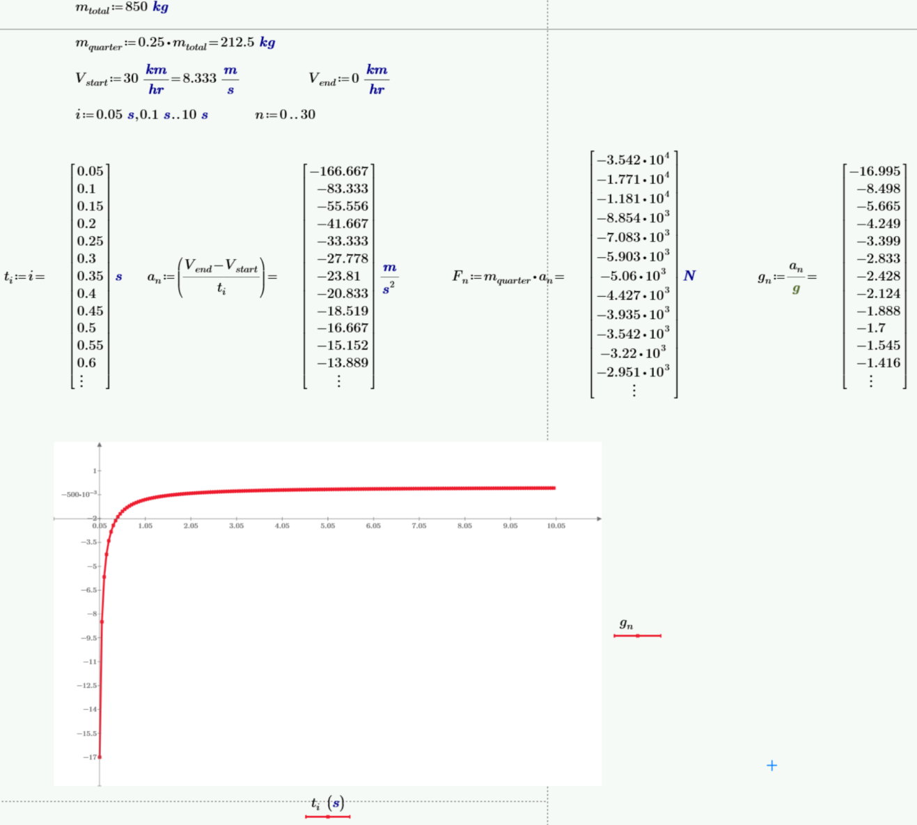

It looks like that both solution are not what I want to get - especially the first one...
Is there any possibility simply to plot the chart where on Y-axis I simply put the a(t) and on x-axis time??? Because this what you proposed it looks tricky and there is necessity to control units. Therefore it is not intuitive ( at least for me ;P )
Please check the photo below made by ptc mathcad. This what I want to do, is to write the same as the function and plot it using the SMath.

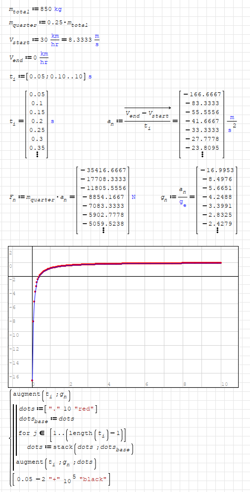

#7 Опубликовано: 29.06.2021 09:46:14
If that plot is what you need, here is your answer.
With function, dots for values and new axes grid {0.05, -2}.
plotting_range.sm (10,98 КиБ) скачан 1184 раз(а).

@ Jean Giraud and @overload Thank you !
This is what I wanted to write in SMath!

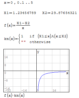

#11 Опубликовано: 29.06.2021 11:17:05
This is what I wanted to write in SMath !
Differently convenient plot ...
plotting_range [1].sm (11,48 КиБ) скачан 1025 раз(а).
