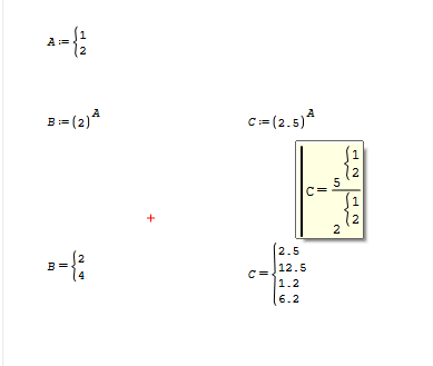

Hi everyone,
I came across to something strange for system of values. as you see in the attached, If I add a integer number for in powering numbers (just in powering numbers not in the other fields) Smath return 4 values and assume it as a fraction and power numerator and denominator separately. How can I tell it to consider the number just as a one value. is there any way to resolve?
Thank you guys
Appreciate any answer and feedback

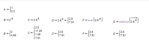

Greetings,
That is a noteworthy observation, I consider this to be a bug.
For what it is worth, to get the program to behave correctly, you can:
  1. evaluate upon assignment (See variable 'D' below)
  2. utilize evaluation upon assignment: eval() (See variable 'F' below)
  3. nest two functions: mat2sys(vectorize()) (See variable 'G' below)
May this be of Good Help;
⚜ Kenny Lemens, P.E. ᵂᴵ

I really Appreciate your quick and effective response. Yes, it works.
