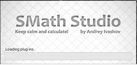

Hello everyone...
I have a problem when I try opening the Smath Studio... It doesn't open.
The version that I use is 0.99.7030.
Can you help me about this problem?
Thanks...

Hello Miguel,
you can try to go into the %APPDATA% path (digit it in the start menu or in the address bar of any explorer window) and rename the SMath folder into something different (f.e. SMath_backup), then launch the program again... It might be even a firewall/antivirus problem, check them if there is some warning.,,
It takes ~ 1 min for the ribbon to end, then opens.

Your Smath should work same as mine:
1. Smath in Program Files
2. All Smath documents in a dedicated directory C:\Smath7030
3. Smath icon in the task bar
4. Click the Smath icon ... wait ribbon ends ~ 2 min

I have experienced the same one or two times before. But it was never possible to recreate this problem afterwards. As I know this is a very old issue which is still not catched...
Any suggestions about how to reproduce this issues are very welcome.
