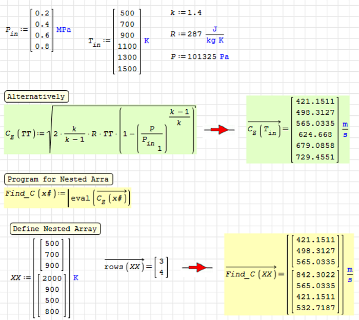

I'm having a little difficulty using matrices. How can I tell SMath to take the first row value from matrix "Pin" (0,2) and calculate formula "C0,2" with each value from matrix "Tin". I then want the result displayed as a new matrix 1x6, if possible (see pictures below). Thanks!
Here is what I want to achieve:

After some tinkering this is what I came up with:
#3 Опубликовано: 28.03.2021 16:11:23
Quite correct, you can plot the family vs the Pin.
Inst_Isentropic Discharge.sm (173,76 КиБ) скачан 1227 раз(а).
#4 Опубликовано: 29.03.2021 03:41:11
NDTM Amarasekera
NDTM Amarasekera
Extended to Nested Array.
Cheers.....

#6 Опубликовано: 29.03.2021 10:02:14
Thanks to both of you, definitively some nice suggestions there!
... more for your project.
You have to work the units that were ignored in this demo.
Page5 Pin_Kin.sm (428,66 КиБ) скачан 1442 раз(а).

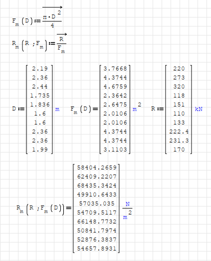

#7 Опубликовано: 02.04.2021 11:15:39
sando99
sando99
0 сообщений из 12 понравились пользователям.
I cannot, for the life of me, figure out what this means:
Can someone lend me a hand with this? Thanks!
Edit: I seem to have figured it out.
#8 Опубликовано: 02.04.2021 14:00:59
A humble suggestion,
Putting vectorize into function prevents further writing errors.
And a subjective perspective, it also looks better.

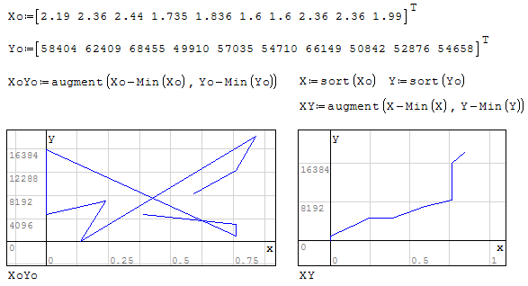

#9 Опубликовано: 02.04.2021 18:06:13
As you give it, there is no immediate suite [interpolation ...]
As given not sorted, the suite is the "Colibri" path.
Once sorted, you can linterp, only.
You can also fillet at will polyline CAD style.
From there, fit and you have something much easier to understand.
You can even have a surface plot.

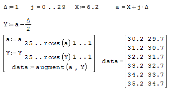

#10 Опубликовано: 04.04.2021 16:22:02
sando99
sando99
New head-scratcher with my project. The circled value should be equal to 34,8 not 34,7. I am open to suggestions where my mistake might be. See screenshot:

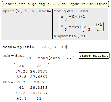

#12 Опубликовано: 05.04.2021 13:12:38
Otherwise generalized ...
