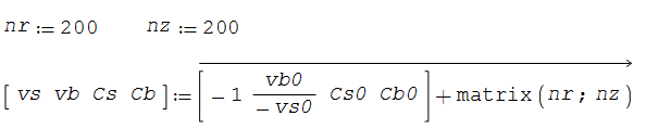

As side note, you might initialize you matrices even like this:
#5 Опубликовано: 29.04.2021 11:05:37

That's what you have in my reply
