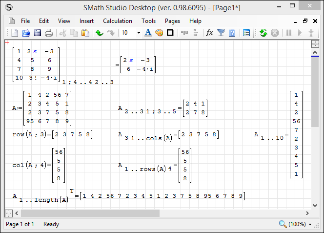

  • Added ability to retrieve submatrix of specified rows and columns using ranges within el(..) function;

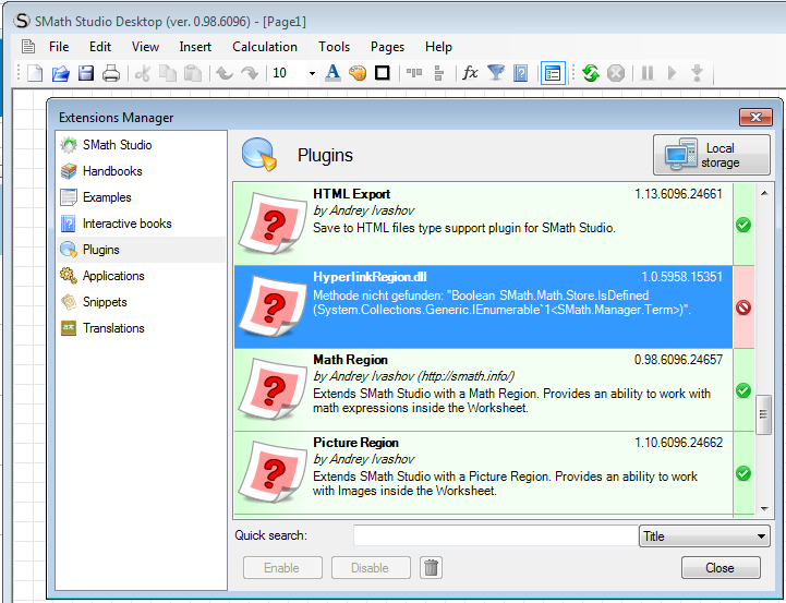

The plugin Hyperlink Region fails to install in the portable version (linux version + portable.version file).
The remove (dustbin) button does not work (plugin remains in the list)
The indicated version is different from the one offered in the installed SMath (6011.17119)
Edit: Also no success with the following plugins in the portable version (no problems in the installer version)

I've finally reproduced issue you have mentioned. It happened because you have put not supported HyperlinkRegion.dll version directly into plugins directory.
  • First of all, Hyperlink Region ver. 1.0.5958.15351 not supported by latest version of SMath Studio. You have to use beta version (please see http://en.smath.info/view/HyperlinkRegion for the link).
  • Second, plugins directory designed to support only plug-ins which are 100% compatible with current version of SMath Studio (usually you can find only built-in plig-ins). All others are better to put under extensions\plugins\\\, even if we are talking about portable version. But be aware, in addition to such a complex path config..ini must be available under extensions\plugins\\ and it should contain a text with version (i.e. folder) of the plug-in to use.
Regarding item 2: to understand it properly just try to install any plug-in using Extensions Manager and then go to extensions folder next to SMath Studio EXE (if portable.version exists) or to %APPDATA%\SMath\extensions (otherwise).
So, if you will correct location of the HyperlinkRegion.dll (and other plug-ins manually put into plugins folder) issue will gone.
