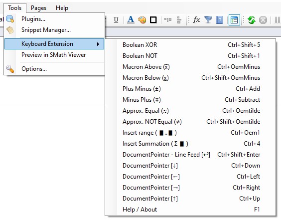

If you are used to Mathcad 15.0, you will have difficulty Creating/Navigating a worksheet because SMath has limited support when it comes to hotkeys/keyboard operations. SMath requires a fair amount of operations to be achieved via the mouse [🖰], which can be annoying (and time consuming) if you wish to type a lot of math/text quickly.
Whereas I did identify some remedies/workarounds (i.e., insert ▮⊕▮ (xor Operator) via HEX code 00A4 [Currency sign symbol: ¤]), this remains a work-around and does not actually address the issue. Therefore, I developed the following code:
'VB.net - Framework 2.0; Windows 10 Pro x64; SMath 0.99.7822.147 [English, USA]

''' <summary>Adds MenuButtons to the Menu Bar
''' MenuButtons are assigned Shortcut keys, to be used within a document (regions need not be selected)
''' Shortcut keys to Mimic some Mathcad 15.0 Keypresses, enhances ability to insert operators within SMath
''' MENU BAR BUTTON LAYOUT:
''' [Tools]
''' [Keyboard Extension]
''' - 「Ctrl」+「%」 :: Boolean XOR (Exclusive or)
''' - 「Ctrl」+「!」 :: Boolean NOT
''' - 「Ctrl」+「-」 :: Insert a Macron (bar) Above the Previous Character
''' - 「Ctrl」+「_」 :: Insert a Macron Below (undlerline) Above Previous Character
''' - 「Ctrl」+「+」numpad :: Plus Minus Sign (Returns a set of 2: the sum And difference)
''' - 「Ctrl」+「-」numpad :: Minus Plus Sign (Returns a set of 2: the difference And sum)
''' - 「Ctrl」+「~」 :: Approximately Equal to (「Ctrl」+「Alt」+「=」)
''' - 「Ctrl」+「Shift」+「~」 :: Approximately NOT Equal to
''' - 「Ctrl」+「;」 :: Range variable [a .. b] (step = 1)
''' - 「Ctrl」+「4」 :: Vector sum
''' - 「Ctrl」+「Shift」+「Enter」 :: Move ✛ to Start of Next Line (Line Feed & Carriage Return Only) "Ignore Region Interaction" Mode --- DocumentPointer - Line Feed [↩]
''' - 「Ctrl」+[↓] :: Enter "Ignore Region Interaction" Mode --- DocumentPointer [↓]
''' - 「Ctrl」+[←] :: Enter "Ignore Region Interaction" Mode --- DocumentPointer [←]
''' - 「Ctrl」+[→] :: Enter "Ignore Region Interaction" Mode --- DocumentPointer [→]
''' - 「Ctrl」+[↑] :: Enter "Ignore Region Interaction" Mode --- DocumentPointer [↑]

Preview:
[Tools]→[Keyboard Extension] (by lemensk)
author: Kenneth M. Lemens (username: lemensk)
date: 2022-12-15
type: IPluginMenuExtender
summary:Adds MenuButtons to the Menu Bar (w/ hotkeys):
Hotkeys work within region, or creates a new region
https://en.smath.com/forum/Default.aspx?g=posts&t=23271
|| MENU BAR BUTTON LAYOUT ||
[Tools]
- 「Ctrl」+「%」 - ▮⊕▮ Boolean XOR (Exclusive or)
- 「Ctrl」+「!」 - ¬▮ Boolean NOT
- 「Ctrl」+「-」 - x̅ Insert a Macron Above
- 「Ctrl」+「_」 - x̲ Insert a Macron Below
- 「Ctrl」+「+」numpad - ±▮; ▮±▮ Plus Minus Sign
- 「Ctrl」+「-」numpad - ∓▮; ▮∓▮ Minus Plus Sign
- 「Ctrl」+「~」 - ▮≈▮ Approx. Equal to (「Ctrl」+「Alt」+「=」)
- 「Ctrl」+「Shift」+「~」 - ▮≉▮ Approx. NOT Equal to
- 「Ctrl」+「;」 - ▮..▮ Range Function
- 「Ctrl」+「4」 - Σ▮ Vector Sum
- 「Ctrl」+「Shift」+「Enter」 - Move ✛ to Start of Next Line
- 「Ctrl」+Arrows - Ignore Regions when moving cursor
Press [Ctrl]+[C] to Copy this message to your clipboard...

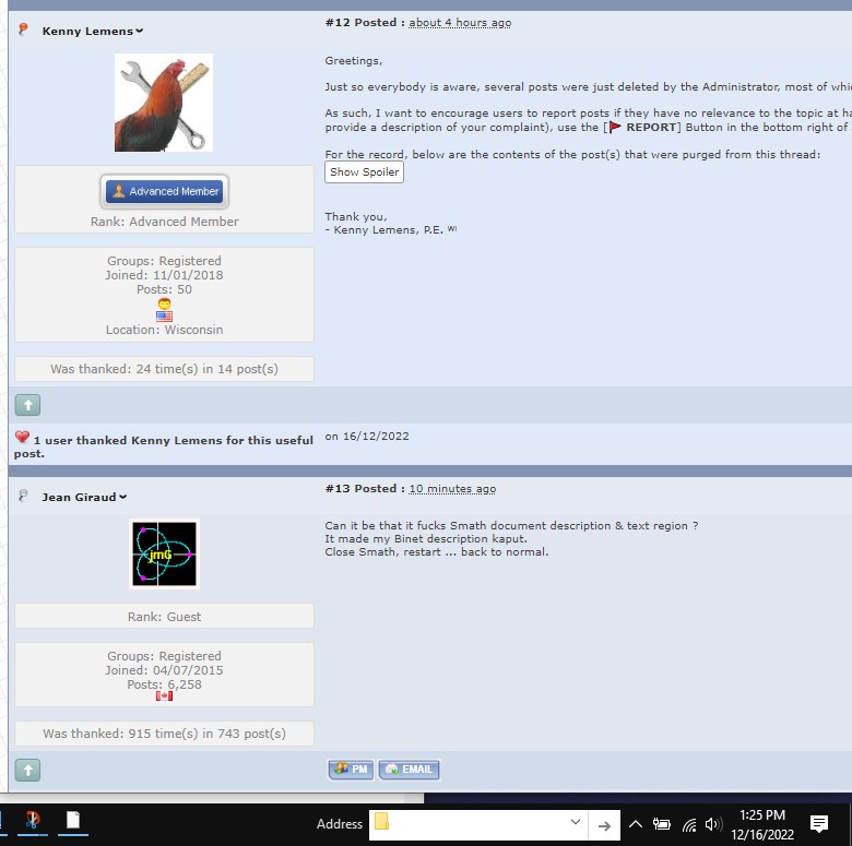

Greetings,
Just so everybody is aware, several posts were just deleted by the Administrator, most of which were off topic and had no correlation to keyboards/keybindings. However, one post did contained profanity.
As such, I want to encourage users to report posts if they have no relevance to the topic at hand; the Administrator has the discretion to transfer/edit/delete depending on the complaint/merits. To report a post (and provide a description of your complaint), use the [🚩 REPORT] Button in the bottom right of any post.
For the record, below are the contents of the post(s) that were purged from this thread:
Thank you,
- Kenny Lemens, P.E. ᵂᴵ
