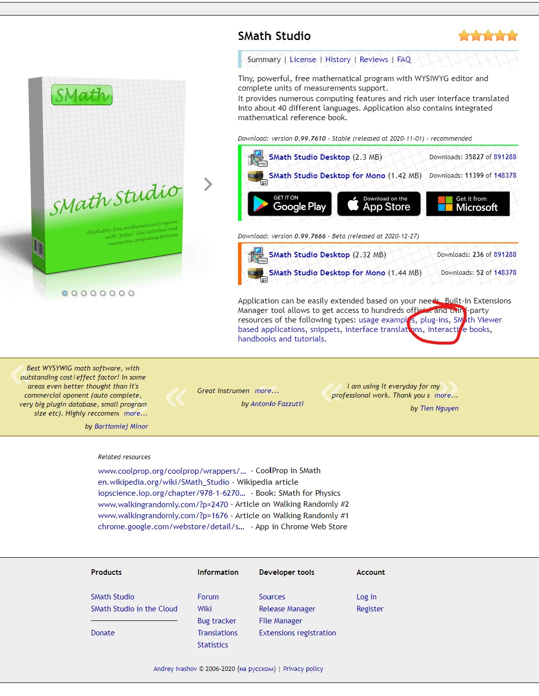

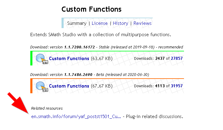

SMath Studio provides automatically an "extension's page" for each plugin (from the hompage click on the ]plug-ins link)
I usually add the link to the forum thread at the top of the "Related resources" section (this is up to each developer since cannot be automated).

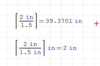

3. I have default set to imperial, but if I use a unit in the equation things seem to go array. Here is a photo:
39.37in is 1m
This is because the function has 0.034m as input => ceil(0.034m)=1m
If I set the Units System to Imperial, I get 1ft as result, because the function read 0.167ft as input => ceil(0.167ft)=1ft
So it seems that the function works correctly with both the systems, but working with units everything is refered to the base unit (m or ft in this case); if you want to "round" a value associated to a multiple you have to divide by that unit inside the function and multiply again outside.

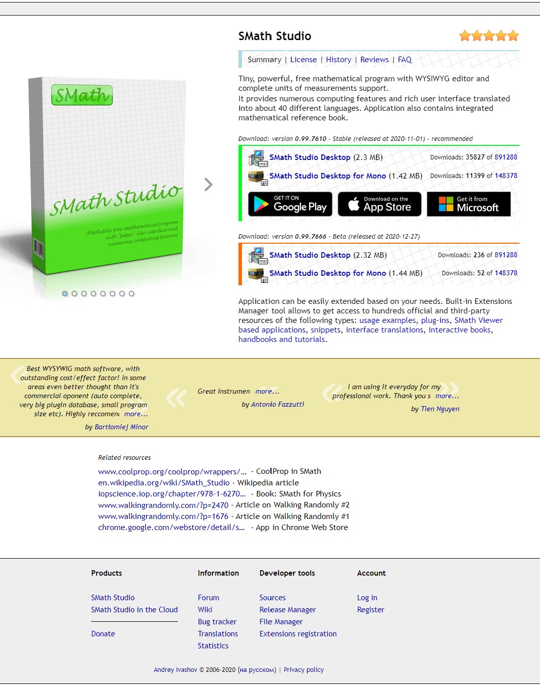

Davide - thanks again for the Reponses. When I try to go to "https://smath.com" I auto redirect to "https://en.smath.com/view/SMathStudio/summary" so maybe there is a difference.
Here is what I see:
