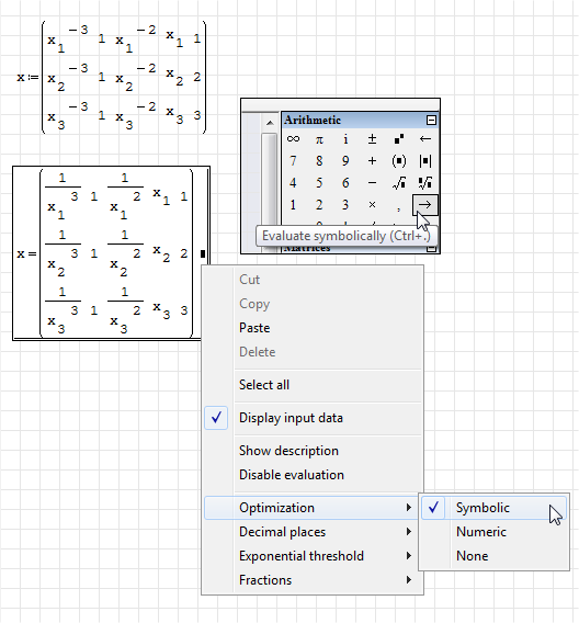

i'm new here but i need your help,
approximation of one variable, but x is unknown and it asks me to define what I do?
below the screen.
#2 Опубликовано: 09.01.2013 07:53:38
Hi Mode,
with symbolic data you must use the symbolic evaluation; you have 3 ways to do that:
- type CTRL+. from keyboard
- click the → symbol from the Arithmetic toolbox
- select Optimization -> Symbolic from the context menu
regards,
w3b5urf3r

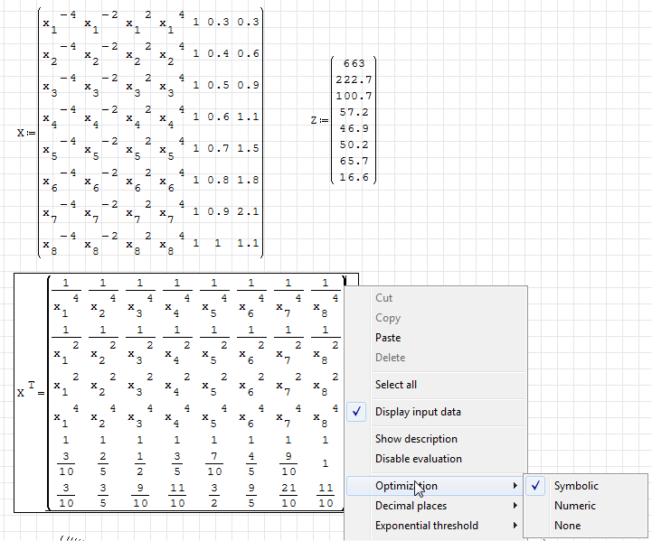

Unfortunetly still have the same problem.
I do as u say and make it symbolic but he still want to define x1
#4 Опубликовано: 09.01.2013 13:06:07
I don't understand why... please look the attachments
P.S. it's preferable to attach files and images directly in the forum instead of using external services
#5 Опубликовано: 09.01.2013 15:32:05
Mode
Mode
Thx very much for helping me with that its working and i'm waiting for result almost 15 minutes and nothing yet
