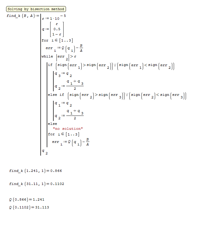

Solving by the old bisection method:
contact stress calc_by_bisection.sm (26,36 КиБ) скачан 1258 раз(а).
sergio 25.10.2022 14:02:00, Alvaro 26.10.2022 14:25:00

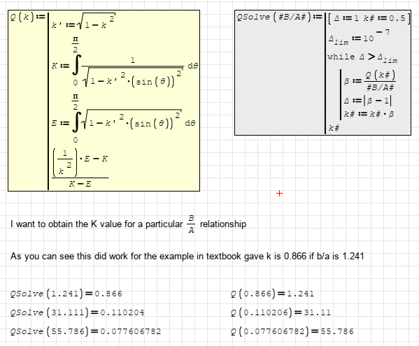

Solving with a custom algorithm.
contact stress calc_2.sm (21,66 КиБ) скачан 1281 раз(а).
Oscar Campo 25.10.2022 12:07:00, sergio 25.10.2022 14:02:00, Вячеслав Мезенцев 25.10.2022 12:43:00
#9 Опубликовано: 25.10.2022 12:08:25
Oscar Campo
Oscar Campo
Very elegant!
