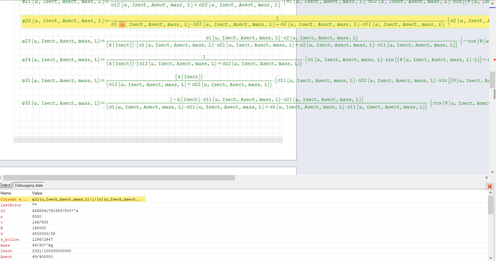

Hi JEAN,
I tried to run your last sheet (TMMT plot roots.sm) BUT a new bug (unknown until now) jumps out
for ALL my sheets involving TMMT algorithm (so, your sheet included....) : could you give me a hint
to solve it?
I'm very surprised and a bit upset: it's not matter of scientific calculation but debugging....
To be noticed that the bug involves SMath sheets previously working correctly (even if something was
signaled, randomly, in the past, for the same function BUT without any effect on calculations)
Many Thanks

.....sorry JEAN to bother you...but I've solved the issue I hinted before...apparently I have ticked (and forgot) the option "Pause" in "Calculation/On Error"...

Sorry JEAN,
I discovered in the meanwhile some flaws that I corrected: I can confirm no "complains" now.
BUT after more than 3h, SMath is stuck on detZ function....
What I ask you is to try to run the "modified version" here attached...Please stop
calculation after 1h running, particularly if, in this timeframe, the roots have not been calculated
: no need to make you also waste energy!

Greetings,
To accelerate your function call, insert the definition of detZ() into a line call (shown below; note the black vertical bar = 'line(▮)' )
You will notice drastic acceleration in detZ() definition; I would repeat this technique for any function that references another function within its own definition (ie., Z(x) and f(x)).
May this be of Good Help;
⚜ Kenny Lemens, P.E. ᵂᴵ
Take your current definition:
detZ(ω):= Φ(ω)₃₃ * Φ(ω)₄₄ - Φ(ω)₃₄ * Φ(ω)₄₃
detZ(ω):el(Φ(ω),3,3)*el(Φ(ω),4,4)-el(Φ(ω),3,4)*el(Φ(ω),4,3)

Thanks JEAN, thanks KENNY,
For KENNY: I'm trying just now your suggestion: a first result is that, in fact, DetZ() is passed away in 50' ...could you be so kind to give me a short hint on how the modification act ? Please,
keep in mind I'm nor a informatic expert nor a mathematicians but only an aeronautical/mechanical engineer with some basis of numerical calculation...
For JEAN, thanks again for all your efforts...about what you call "Clean roots", please take into consideration that complex results (with small
imaginary part, let's say < 5% of real part) are acceptable: it probably means that the vibration has components on both normal axis...
More, these methods are used mainly in preliminary dynamic&vibration verification (hence 5% error is more than good). By the way in one of the
original version of the my SMath file (ThreeHollowBeams_SteppedBeam) the calculation ended after 1h & 50' on solve (......) with the error message:
"No real roots"...I do not think it's matter of units (it worked in previous SMath files...). But on the other side, I do not know how could I ask to have even
complex roots...
Plus, do not consider negative axis and max the first 5 roots (lowest frequencies are always the most 'tedious' and a modal basis made by first 5 modes/frequencies
is more than adequate if we should want to consider an "answer" of the structure): this should limit the values (even if, to be honest with you, when I studied the same
cases in MathCAD, values of 10e18 were not uncommon).
complex roots...
Keep in touch
All done correct in few minutes vs hours.
Quick plot 10 min ... X_Y less greedy.
No imaginary roots encountered.
For 12 Decimals roots ... Dichotomy.
Explore from command line, or meshed data XY.
Jean.
TMMT plot_roots V2 part doctored.sm (126,77 КиБ) скачан 1715 раз(а).

Oscar Campo 01.09.2023 07:40:00
I deleted most of non associated to document.
Every demand is greedy ... plots, solve, export.
At the point of Export, copy/paste in new sheet
for total independence, inspection.
Cheers ... Jean.
TMMT plot_roots V2 part doctored.sm (145,06 КиБ) скачан 1747 раз(а).
Cheers ... Jean.
