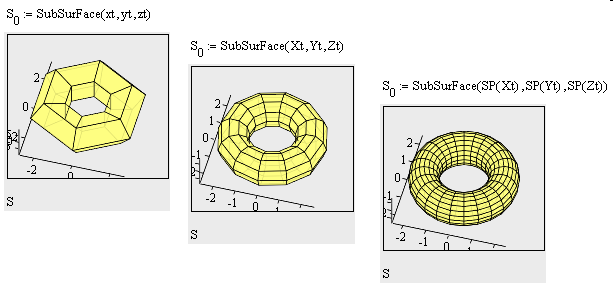

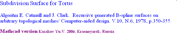

Wait and see assuredly nice. How useful to Design Engineer ?
I dream of Smath implementing the Mathcad 3D matrix style.
It could probably allows the design Engineer to supply the 3D data
to the machine shop from Catmul-Clark ... meshed as fine as desired.
