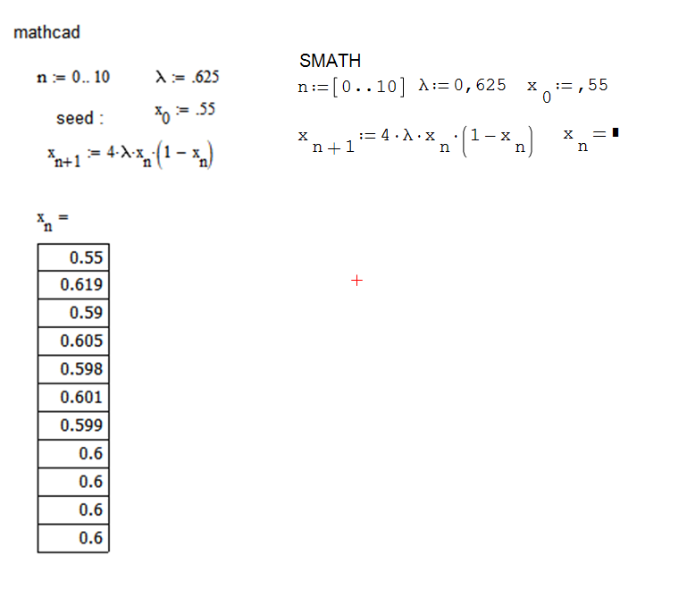

Hi there,
I am migrating my old mathcad files to Smath.
As you can see in the uploaded picture i tried
to emulate the function in Smath without succes.
I know that i can write a few line code to achieve this.
But I want to keep it easy readable for people who are not
so fit in reading code.
Does somebody have a hint how to achieve this?
#2 Опубликовано: 28.03.2021 15:18:26
Hi Adrian. SMath it's ORIGIN = 1, and you can't change it. It's probably best to rewrite the code in Mathcad for ORIGIN = 1 and then move it to SMath.

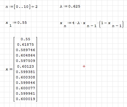

This works, if it suits you.
Regards.

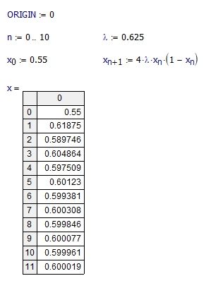

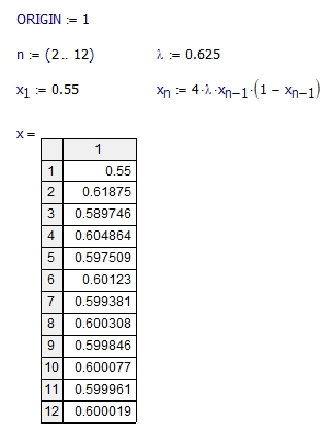

Hi Adrien (sorry, I wrote Adrian before). ORIGIN it's an option for Mathcad, not for SMath. You can read about it in the Mathcad help here. As another example of changing the array origin, you have the 'Option base 1' in visual basic.
This is your code in Mathcad with ORIGIN = 0, which is the default value:
Here, the same Mathcad code with ORIGIN = 1:
Finally, you can translate it to SMath:
Notice that the scan in SMath under the index array isn't that complete like in Mathcad nor Matlab, and usually you can use only variable ranges but not operations over those ranges in the left-side of the assignment.

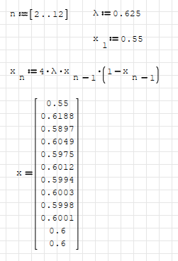

You ambiguate yourself between the two .
Try this same/otherwise than Alvaro ... Jean
Page7 Recursive Otherwise.sm (20,53 КиБ) скачан 1389 раз(а).
#7 Опубликовано: 28.03.2021 20:35:23
... added the graph.
Page7 Recursive Otherwise.sm (22,29 КиБ) скачан 1343 раз(а).
#8 Опубликовано: 28.03.2021 20:43:57
... This one is anchored at ORIGIN 0 [X,Y]
Page7 Recursive Otherwise.sm (22,4 КиБ) скачан 1382 раз(а).
