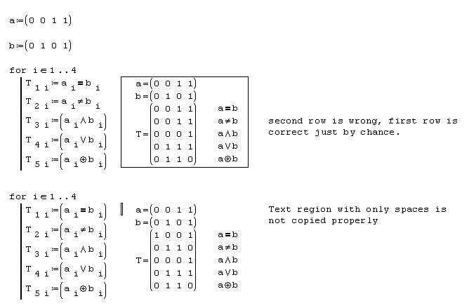

Edit: Additionally, the equal and not-equal operators silently adopt the same lower precedence like the mentioned boolean operators, but do not enforce brackets around their operators. This leads to wrong results.
The issues remain open in 0.96, in particular the cited issue is dangerous.
