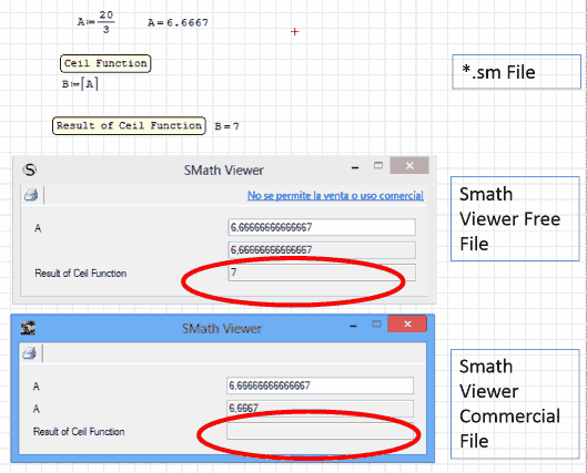

Ceil Function does not Work in Smath Viewer Commercial
Carlos
Ceil_Function.sm (2,79 КиБ) скачан 1301 раз(а).

I've recompiled Custom Functions plugin for the latest APIs, please check if the issue still exists after downloading the updated plugin or if we need further actions from Andrey side.
edit: third party plug-ins are not yet supported by SV commercial (see here for reference)

I updated the custom functions , but the result of the function Ceil not shown in Smath Viewer commercial.
Thank You
