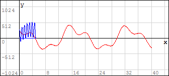

Hello SMATH Collaboratory,
Attempting to transfer a worksheet from MC Prime to SMATH. Couldn't get page 3 of my SMATH sheet to augment the x & y data for the graph; I tried a few variations , yet unsuccessful. I welcome any input(s)/recommendation(s).

Hi Nasch. This is an option.
Review of System Transients.sm (158,95 КиБ) скачан 1318 раз(а).

Here's the updated worksheet.
Review of System Transients.sm (197,75 КиБ) скачан 1287 раз(а).
The graphs differ some from the MC version, also some added data/lines in the graphs are exhibited.
Thanks again Alvaro. Your experience with SMath is indispensable!

Ah-h! I tweaked the 1st line under the "for" loop and the graphs are better.
Something like this ?
Review of System Transients (2).sm (280,61 КиБ) скачан 1306 раз(а).
#7 Опубликовано: 19.01.2023 14:38:46
Hi Norm. This version returns the same plots. Initials conditions in yellow.
Review of System Transients.sm (233,04 КиБ) скачан 1329 раз(а).
