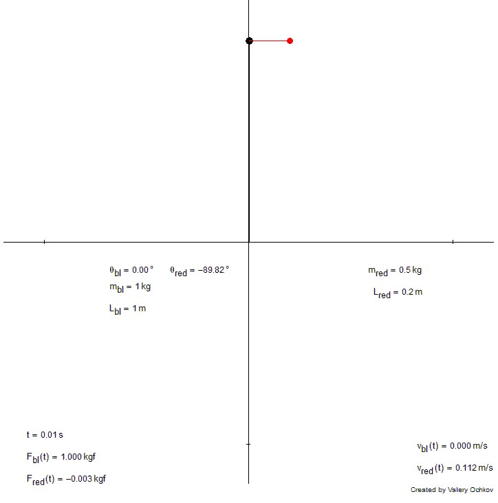

Valery Ochkov
Valery Ochkov
67 сообщений из 713 понравились пользователям.

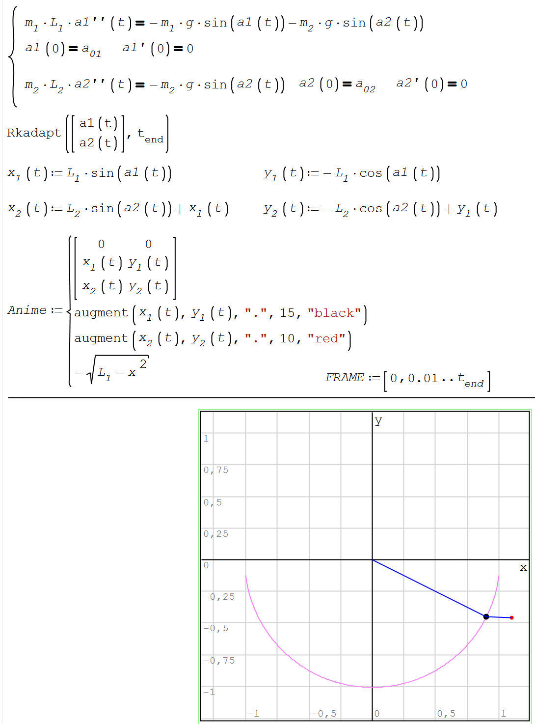

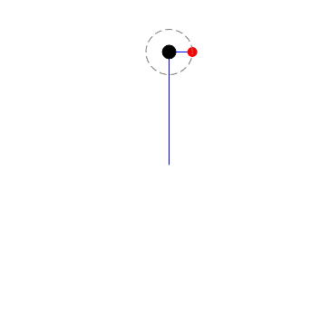

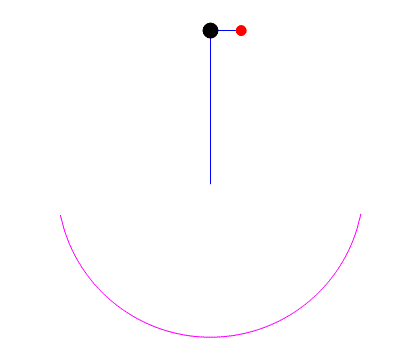

Hi friends!
Now I am on the forum again!
Anime2.sm (55,59 КиБ) скачан 1025 раз(а).
But the model is not correct. See please Alvaro model!
Отредактировано 30.10.2025 19:22:14

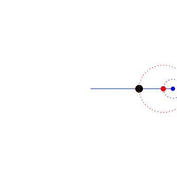

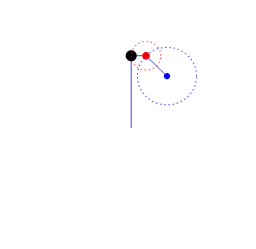

#2 Опубликовано: 29.10.2025 10:45:45

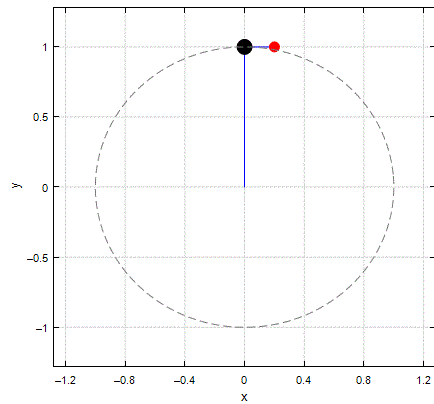

Using X-Y Plot
Anime2-xyplot.sm (57,84 КиБ) скачан 1059 раз(а).
sergio 29.10.2025 14:50:17, Ricardo_Herrera 03.01.2026 14:15:17

And where here is a bug?

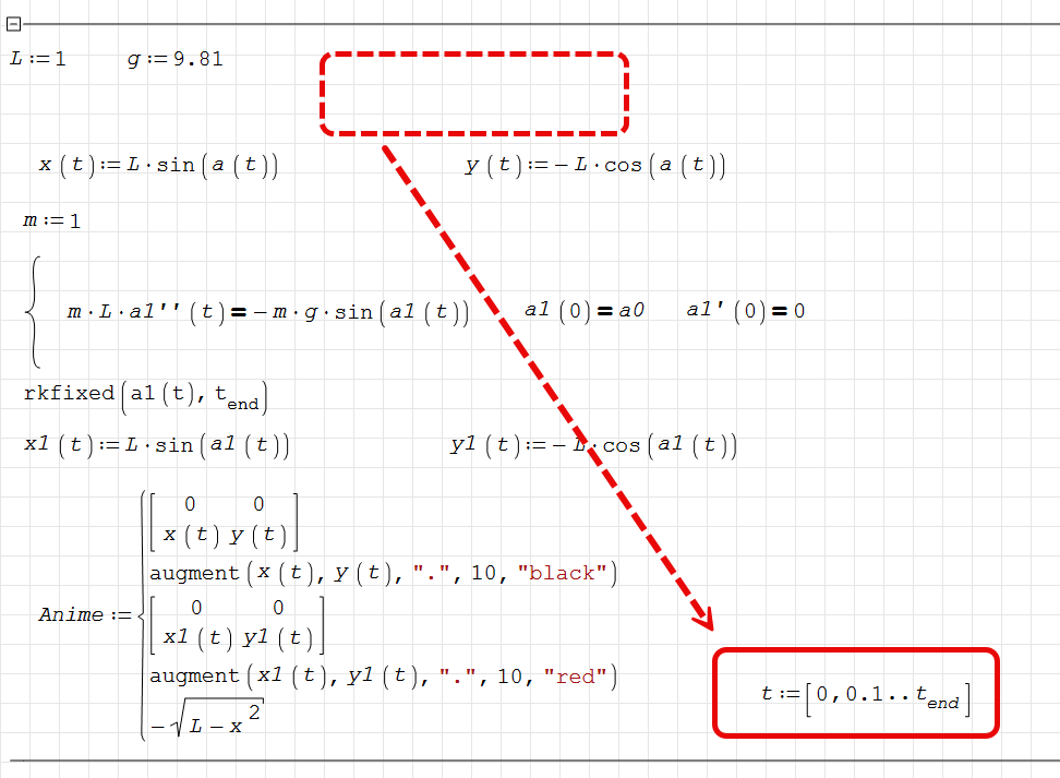

#5 Опубликовано: 29.10.2025 14:01:44
Vector t must be defined below before the component.
The animation feature is still being developed when I have time for it.
Отредактировано 29.10.2025 14:05:45
Alvaro 30.10.2025 07:04:42

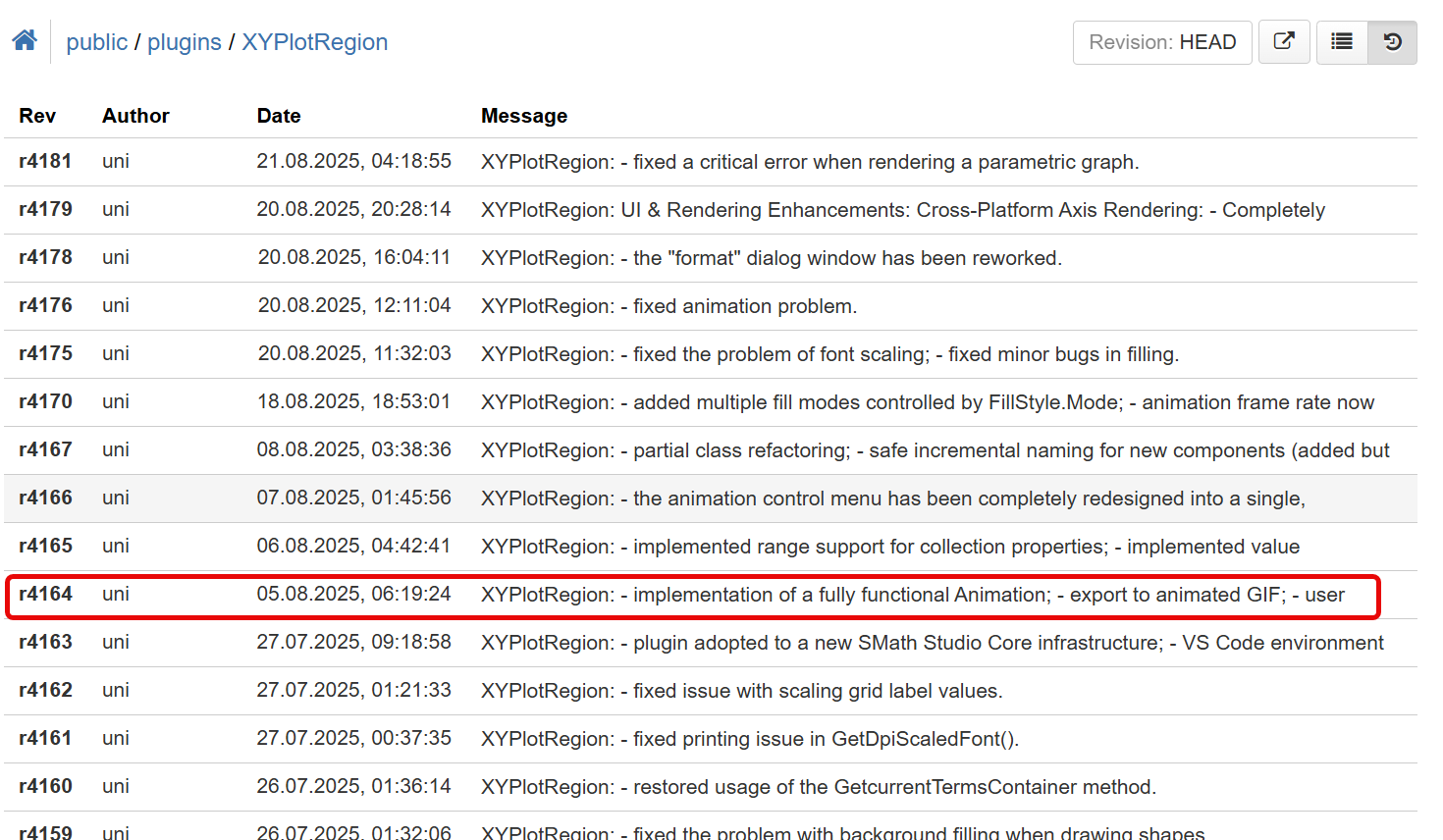

#6 Опубликовано: 29.10.2025 17:02:10
Valery Ochkov
Valery Ochkov
Слава, а когда этот новая версия плагина появилась?
#7 Опубликовано: 29.10.2025 18:19:29
В конце лета.
Отредактировано 29.10.2025 18:21:02

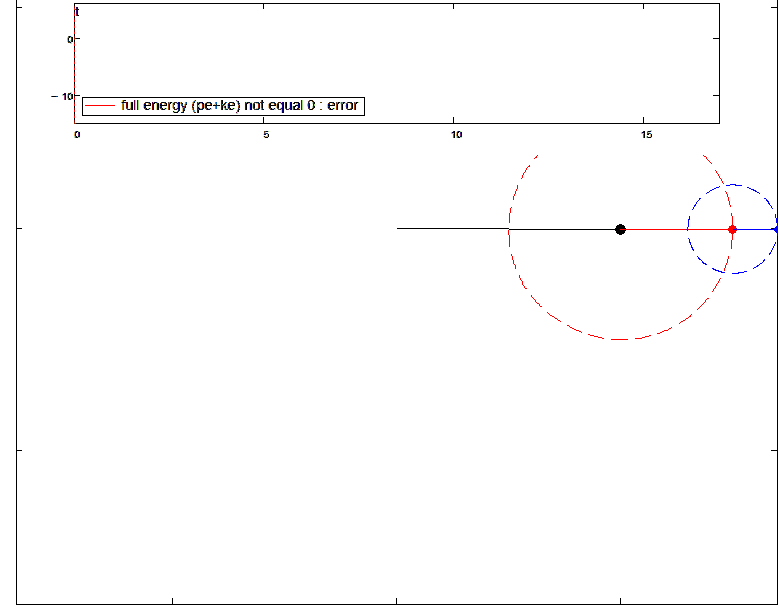

Triple pendulum - see errors at the second haft of time interval.
Pendulum-3-for-SMath.xmcd (220,62 КиБ) скачан 1127 раз(а).
Отредактировано 30.10.2025 19:39:16
Alvaro 31.10.2025 05:05:16

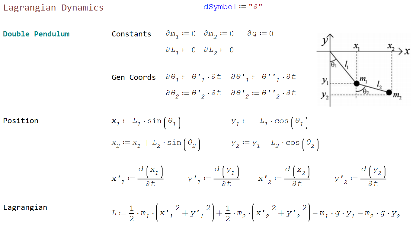

Hi. Using pure SMath code to deduce the equations of motion from the Lagrangian, with the functions in this post: https://smath.com/en-US/forum/topic/AeeMSM/Using-differentials.
double_pendulum_lagrangian.sm (174,64 КиБ) скачан 1013 раз(а).
double_pendulum_lagrangian.pdf (503,4 КиБ) скачан 761 раз(а).
Valery Ochkov 31.10.2025 07:37:56, sergio 31.10.2025 08:48:37

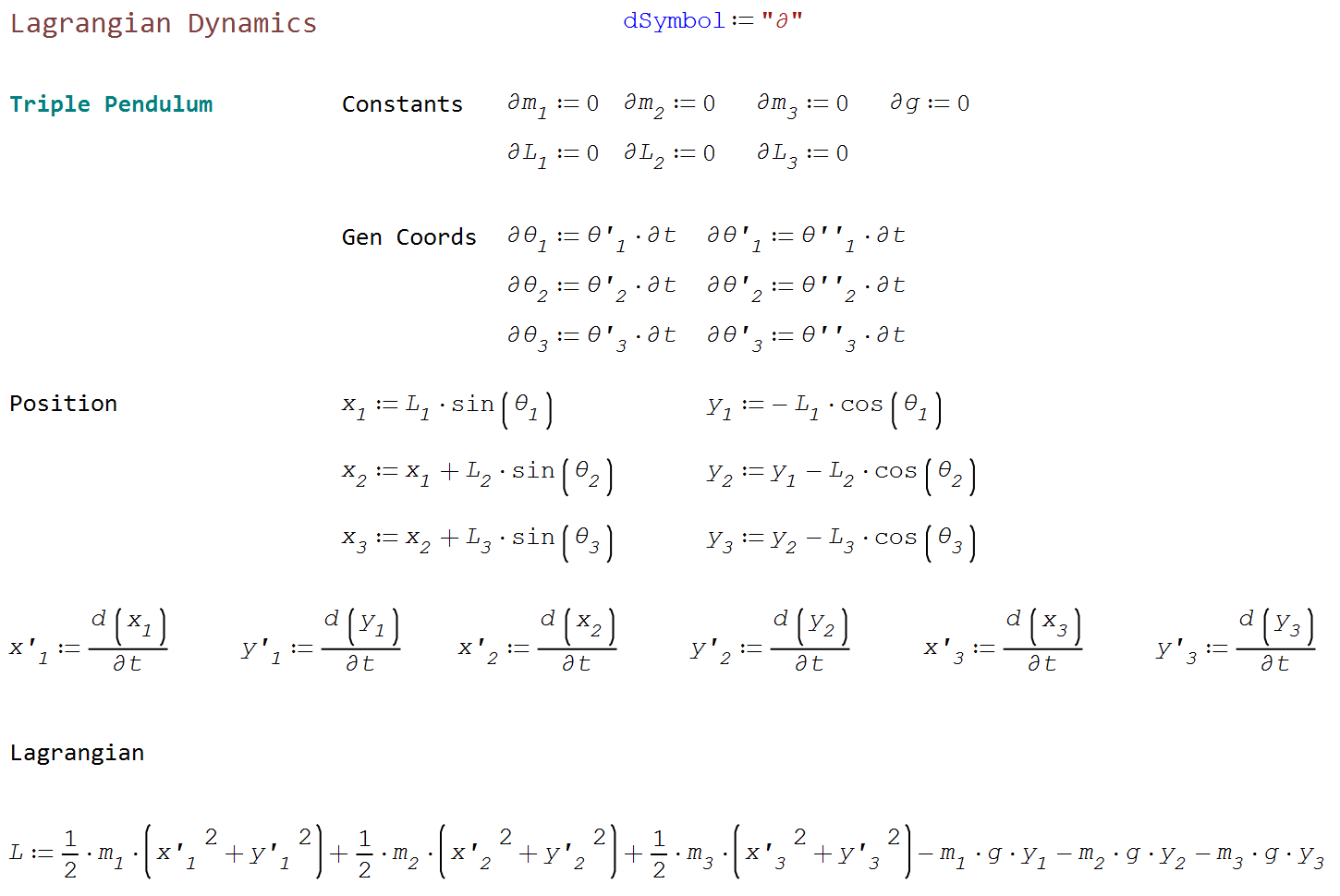

I no longer use Mathcad, except on rare occasions, when I rely on Mathcad version 11, which I consider the last decent version. So I can't see the triple pendulum file. And I suppose this is the situation for many SMath users who no longer have Mathcad readily available. But more than worrying about the conservation of energy, which seems to be a problem with the numerical method used, I'm more surprised to see how the future affects the past, since the animation shouldn't alter the trajectories already described by the particles as time passes.
This is my approach to the triple pendulum.
triple_pendulum_lagrangian.sm (135,01 КиБ) скачан 992 раз(а).
triple_pendulum_lagrangian.pdf (248,09 КиБ) скачан 624 раз(а).
Отредактировано 31.10.2025 06:13:23
Valery Ochkov 31.10.2025 07:38:10, Вячеслав Мезенцев 31.10.2025 07:18:43
For me too!

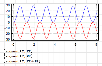

#17 Опубликовано: 01.11.2025 01:52:48
Valery Ochkov
Valery Ochkov
See pls pdf
With those values:

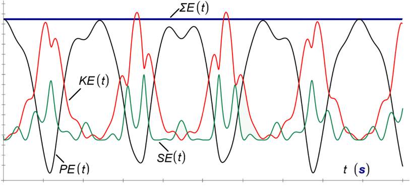

One my plot:
Change of three types of energy of a swinging pendulum on an elastic suspension - SE - the spring energy
Отредактировано 01.11.2025 01:55:02

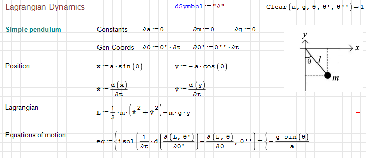

Is it posibble to solve the single pendulun problem with Lagrangian and rkfixed but without the al_nleqsolve function?
Отредактировано 05.11.2025 08:29:15
#19 Опубликовано: 06.11.2025 04:03:01

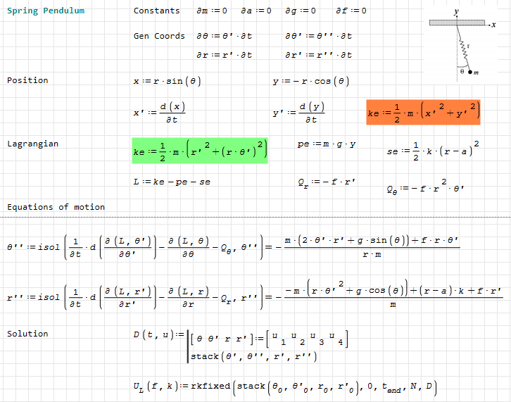

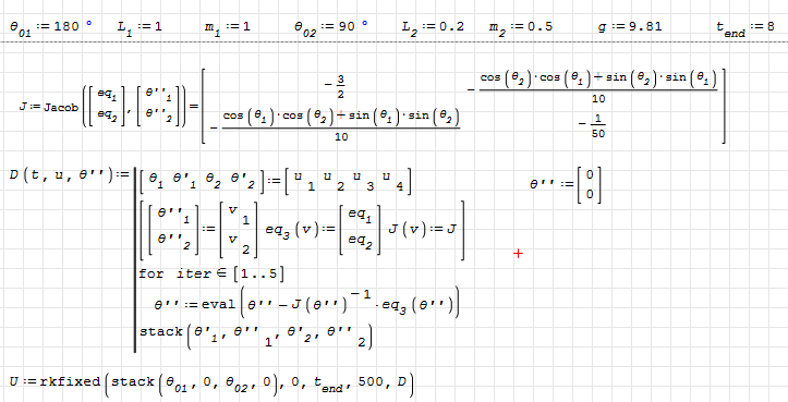

Hi Valery. For the single pendulum you can get the lagrangian from the olf post about differentials ( https://smath.com/en-US/forum/topic/AeeMSM/Using-differentials ) It's very simple and doesn't require much processing to use rkfixed.
For the double pendulum, you can use Newton-Raphson to solve the system within the function D. Here, a very simple version of the method is used.
double_pendulum_lagrangian-NR.sm (178,15 КиБ) скачан 1006 раз(а).
Something similar applies to the pendulum with a spring. Note that the Lagrange equations become somewhat complicated because I use the x,y coordinates to calculate the kinetic energy, and SMath cannot simplify trigonometric functions. However, if you use r, θ' (in green), the equations of motion are greatly simplified. But that breaks the principle that the program should do the calculations, not the user.
Valery Ochkov 06.11.2025 05:16:18
#20 Опубликовано: 06.11.2025 11:47:20
Valery Ochkov
Valery Ochkov
Hi Alvaro!
Can you create this simple sm-file with animation? Single pendulum!
Thanks!
