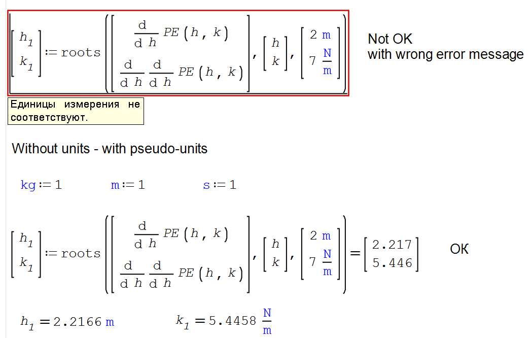

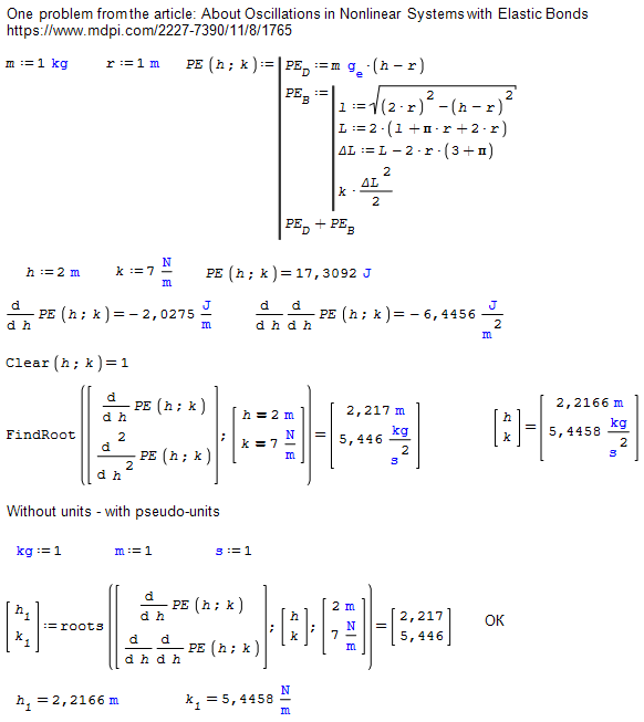

Can Roots and Solve functions work with units?
See please the attach!2-4-OOO-Plots-DD.sm (14,94 КиБ) скачан 1429 раз(а).

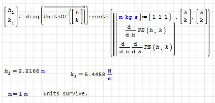

There are several ways to handle units with SMath roots. This is one of them, where the units are sterilized (Pompelmo' dixit) locally, instead of globally.
2-4-OOO-Plots-DD.sm (12,96 КиБ) скачан 1392 раз(а).
Thank you, but this is very difficult for me.
The question was simple: Roots & Units.
#7 Опубликовано: 19.05.2023 20:08:52

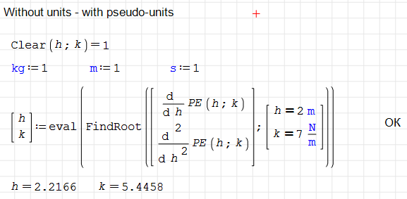

It is simple, if you use Findroot()
2-4-OOO-Plots-DD_Kr.sm (16,37 КиБ) скачан 1397 раз(а).

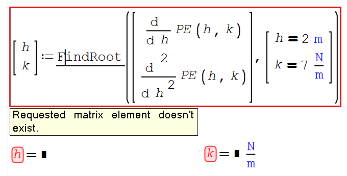

Why?
#9 Опубликовано: 20.05.2023 19:29:49
Why ?... Not coded as per the plugin instruction code.
Valery Ochkov 21.05.2023 02:14:00
#10 Опубликовано: 20.05.2023 20:02:35
Why?
Use eval(), sometimes it resolves problems.
Especially it is useful on some solver situations.
