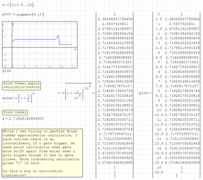

Is this a bug or calculation limitation?
euler.sm (10,33 КиБ) скачан 1576 раз(а).

Hi overlord. It's a numerical round-off issue. For example you can get the same issue in excel, with more or less same values.
round-off-error.pdf (204,46 КиБ) скачан 864 раз(а).

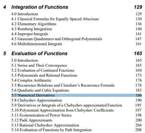

- This kind of errors make more pedagogical to study first numerical algorithms for integration and then derivatives, and sometimes the function evaluation. Here an example of the Numerical Recipes in C index

Thank you Alvaro,
I had only checked this formula only with wolframalpha website.
On it, there were no issues, everything was smooth.
Then I tried it with SMath and get those results.
After your post I calculated with Mathcad and Mathematica.
Results are worse over them. Mathematica can not calculate after exp(7).
On Mathcad results have same spike and they are settled on 1 after it.
So this is basically a limitation. No need to investigate further.
