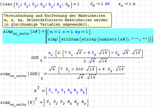

Yet while responding to the above post, It comes to my mind that one could try to convert variables to units (with safe names), perform simplification with the str2num-num2str workaround and then convert everything back to the original variable names. I will give this a try but it may get spoiled by non-matching units errors.

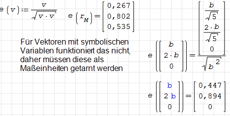

Here is an example of a worksheet with extensive usage of units for unknowns.
1-2-Maßeinheiten.sm (152,28 КиБ) скачан 1402 раз(а).
