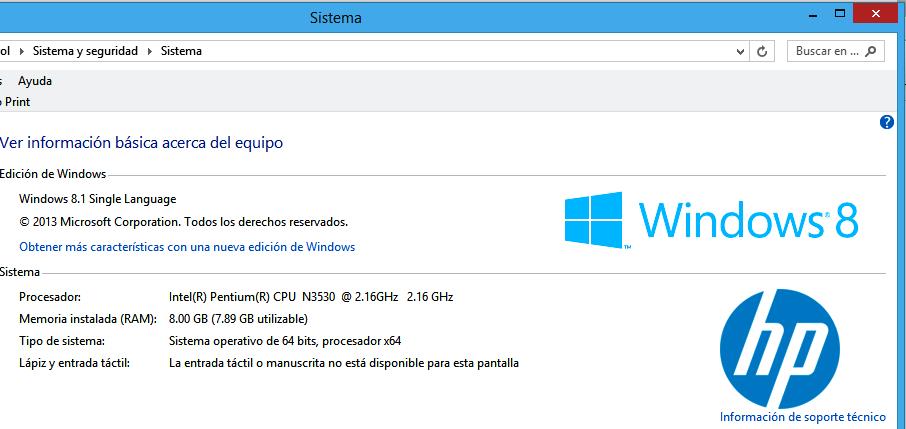

Since Smath Studio 0.98.5908 I can't install on my computer.

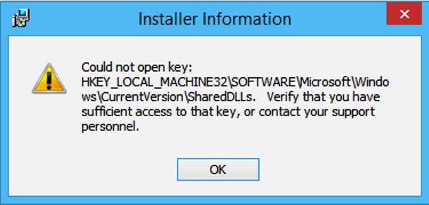

The instalation stops and warn me:

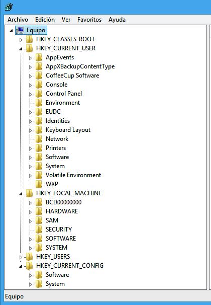

I can see that it has to be with my system, not with Smat Studio , because my system don't have the referred KEY.
Can someone help me with this issue?

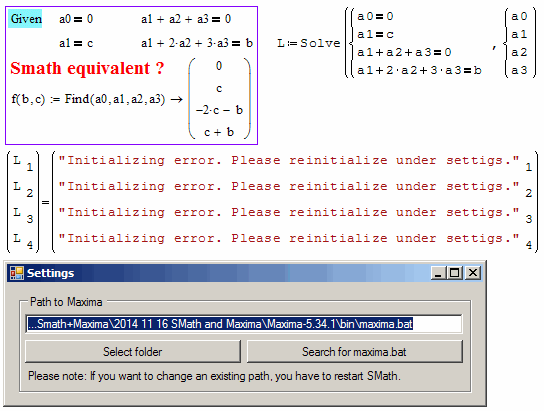

Same thing Smath 5346 XP SP3: Smath does not exist in the Registry.
A faint vxMax that does not necesarily implies Maxima. That's
probably why Maxima does finds itself in the jungle, except for
Maxima stuff that comes from the Insert menu f(x).

Can you check the permissions of HKEY_LOCAL_MACHINE\Software\Wow6432Node\Microsoft\Windows\CurrentVersion\SharedDLLs?
This is the place where your HKEY_LOCAL_MACHINE32 path should redirect to.
My Win7x64 has the following:
Everything is INHERITED from MACHINE\Software\Wow6432Node
Users - read (this key and subkeys)
Administrators - Full access (this key and subkeys)
System - Full access (this key and subkeys)
Creator-owner - Custom (everything checked) (Subkeys only)

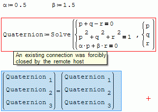

#11 Опубликовано: 17.03.2016 01:59:03
Mike Kaganski
Mike Kaganski
Jean, I suppose yours is not "same thing", but a totally different case! You have SMath installed successfully, only Maxima plugin fails to function properly. I'm really sorry, I cannot help here: I know nothing about Maxima.
