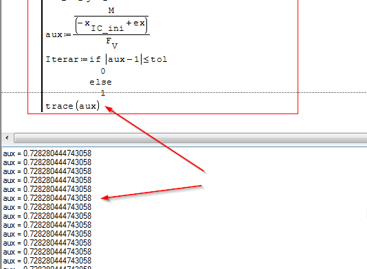

I need help with this routine. I created a loop with while function, but it takes too long in finding a solution.
I think code its OK, but I dont know the software limitations... (I programmed the same in scilab and worked well)
Thanks in advance.

It seems (not sure) that your code does not change the exit loop condition and you are in infinite loop - see the picture please.

But why?? I tried to use a for loop, but it's the same result. First I thougth it was because of the units, so I take them away from the matrixes, but now I'm running out of ideas...
I tried doing a second loop, without for or while, but again the same...

at the end of iteration, nothing changes. iteration means values you start with have to change for the next iteration. same values are being used in every iteration. same aux is being calculated every time. the loop can not end this way. at the end, i am saying the same thing that omorr have said i hope i could help.
you were rigth, i forgot to redefine xIC_ini in the last else... thanks
