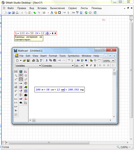

Why this not working?

because of caps?

I use russian units. They do not work. I don't know is this a bug or not. English units are working fine.

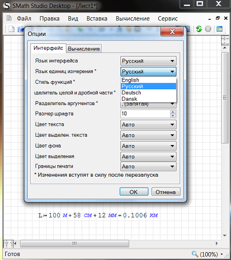

#4 Опубликовано: 11.07.2014 04:21:03
I managed to make a total mess by changing languages. I think this is something connected with Units also.
(SMath nightly build 0.96.3501, x64 Win 7)
See this video please changing languages problem (~5min long)
Until I figured out how to get SMath back, I installed/unisnstalled it few times, Repair it few times etc. - but nothing helped until I I did as presented in the video - changed the language "blindly". Actually, I do not know how to completelly remove SMath from the system and make a "fresh" install?

Thank you Radovan, now it works fine (default was English.).
