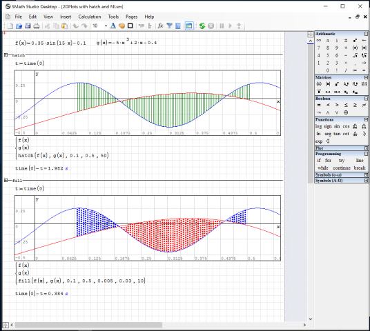

Anyone using a MS Surface tablet with SMAth? Do you have any display issues? Or on any other high-res displays? its a 2736x1824 at 267 PPI display.

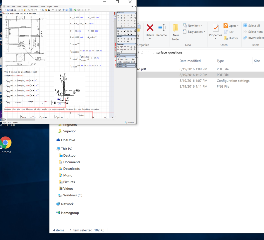

One of my pages erred out and then SMath resized the program window by itself. At first I thought that it might be a display scaling issue- I have had issues with other high res programs (Autocad for example)... info on this page
https://www.microsoft.com/surface/en-us/support/apps-and-windows-store/app-display-issues?os=windows-10&=undefined#S2
Here is a 'normal' page as it appears-
.PNG)

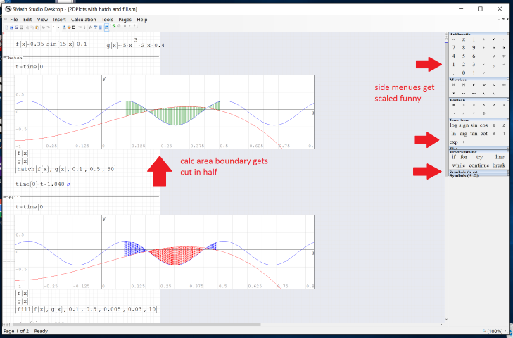

Here is SMath after it resized itself. The crop is the same size as the previous one
.PNG)
If I disable display scaling for smath, my page boundary for calculation area and output gets shrunk and the side menus get funky.

So, I've started investigation and I see issue is in ImageRegion. You can disable or delete ImageRegion plug-in using Extension Manager and described issue with scaling will never happen again (SMath Studio will show Dependencies window on file open, but you can just Close it and press Yes in final confirmation dialog).
Regarding errors shown on the worksheet. They are because of "#N/A" retrieved from Excel sheet. Just open Excel sheet you use and correct content in order to fix this "#N/A" error in sheet cells - it will fix SMath worksheet as well.
Unfortunately I didn't manage to find an exact problem in ImageRegion, but it is only question of time...

WroteIt is the most curious behavior when the smath resizes itself on error.
Yeah, it looks very strange.
SMath Studio has no logic to resize itself on error
This behaviour caused exactly by ImageRegion. Do not know why, but it seems this plug-in uses some calls to the Office or to OS which causes switching process-initiator into some safe mode. And because of this plug-in executed in the same process together with SMath Studio we have what we have - system switches SMath Studio to some special mode without asking anyone...
If this error appeared in latest versions only, then we must check previous versions of the ImageRegion to see what was changed their.
