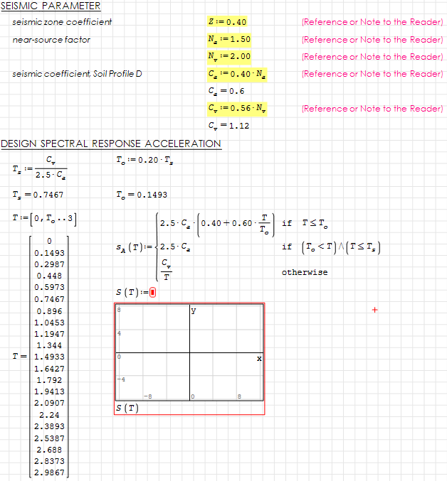

So I was shifting from Mathcad to SMath and I can't seem to do this properly. How do I get around graphing this response spectra.I'm quite new to SMath so please be understanding if I don't know of some functions within the program.

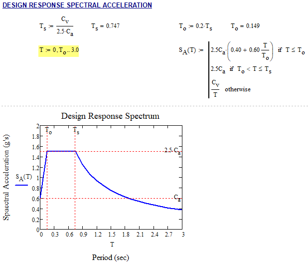

This is hot it works finely in Mathcad, what would be your suggestions?

The issues:
The function was made using "while", that is a loop iterator. You have to use if(), or cases() if you prefer (the latter is part of a 3rd party plugin).

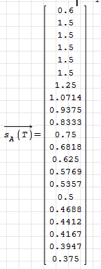

The evaluation for multiple values has to be done using vectorize() or alternatively by a loop
![2023-05-09 12_37_51-SMath Solver - [Design Response Spectra_00.sm].png](/ru-RU/files/Download/T3rpxR/2023-05-09-12_37_51-SMath-Solver---[Design-Response-Spectra_00.sm].png)
The built-in plot variable is always x for static plots, t to add animations.
![2023-05-09 12_37_44-SMath Solver - [Design Response Spectra_00.sm].png](/ru-RU/files/Download/SZaC8p/2023-05-09-12_37_44-SMath-Solver---[Design-Response-Spectra_00.sm].png)
