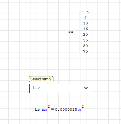

Здравствуйте.
Используем Вашу программу в небольших расчетах. Очень нравится визуализация расчетов, когда требуют предоставить формулы расчетов.
В работе используем расширение список или комббокслист, в расчетах очень часто встречается выбор. С недавнего времени начали вводить в расчеты единицы измерения, и это привело к проблемам со списками. Можно ли сделать так что бы выбираемые значения имели те же единицы что и указанные в матрице? Прикладываю проблему.
Возможно мы что то не знаем и все уже решено. Заранее спасибо!!!

If you really want to choose those values, you can create the list without units and apply the units in calculation. Note that the result of calculation will still be in SI, and you'd have to change those manually as well if you wanted to show different units.

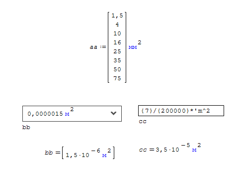

To simply improve your choice in the combolist, with a little extra work, you can do this:
Thank you very much! This is what you need!

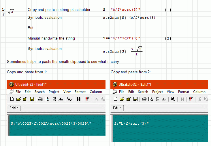

sergio, many thanks, really convenient. But there is one more problem. We have a choice of formulas by which the calculations will be performed and we want to display in the report those formulas that we use.
"S: d / {s * a * rrr} * sqrt (23)" - the program correctly converts this construct into a formula only in ComboBoxList
In other places, the program still displays "S: d / {s * a * rrr} * sqrt (23)"
In which element of the program you can beautifully derive the formula (comboBoxList does not look neat for this task). I liked the formatted label extension, but it also only displays the text "S: d / {s * a * rrr} * sqrt (23)" (((

Hi. I guess that this is the origin of the problem:
StringProblem.sm (21,45 КиБ) скачан 1234 раз(а).
I tried to write hands and paste from a notebook in the coding of UTF-8 and ANSI. Repeat what you did under (2) did not work.
My version of the program is 0.99 (6884), maybe there have been changes?
I'll try to update.
Update did not help.
