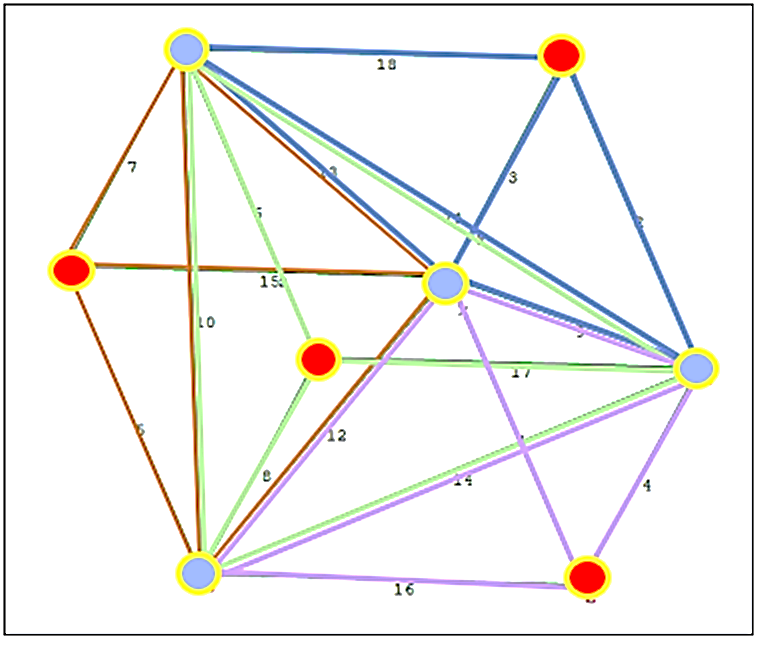

I thought on another nice issues for using tetrahedrons, based on the decomposition of an irregular hexahedron into four linked tetrahedrons as here:
In such way we can create a sort of super element, with an unique output insted of four and also with only 24 input coordinates instead of 6*4*3=72.
The hexahedron finite element is often prefered.

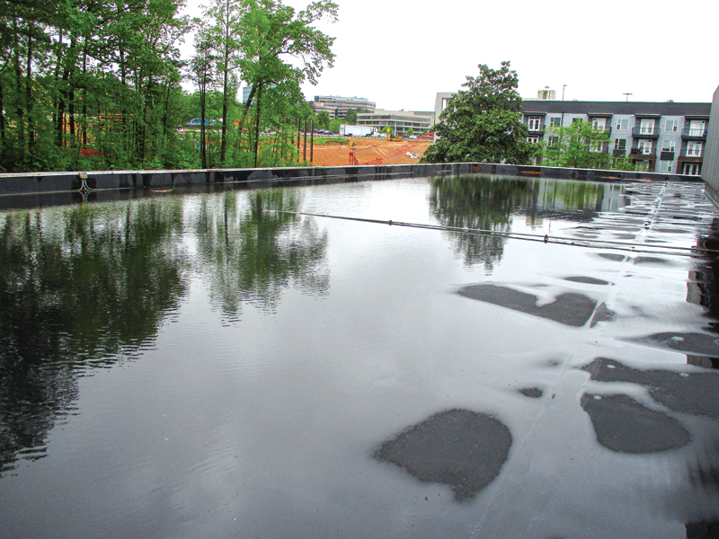

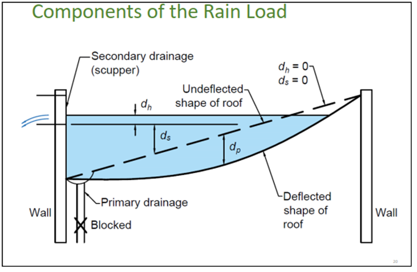

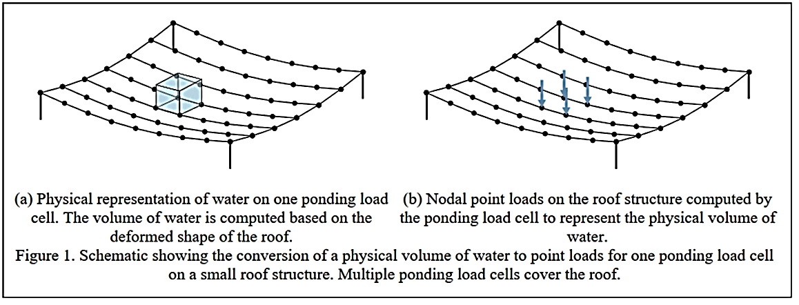

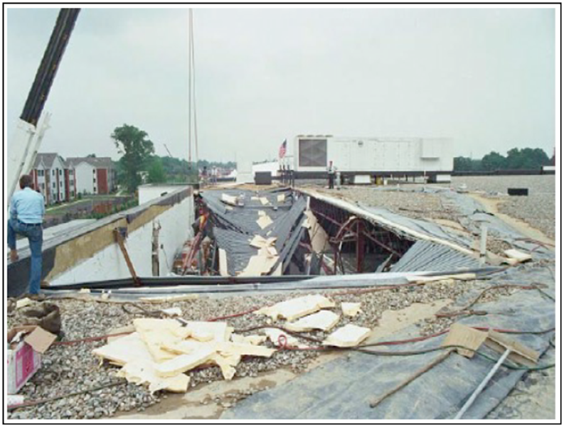

My starting point on this topic was not mainly the Finite Elements, but a problem about the analysis of the "Water ponding on contructions roofs". This problem contains some geometrical nonlinear aspects.
