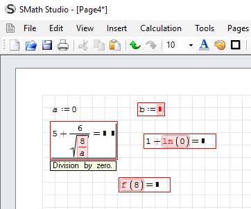

  • Part of the equation which causes an error is highlighted now;

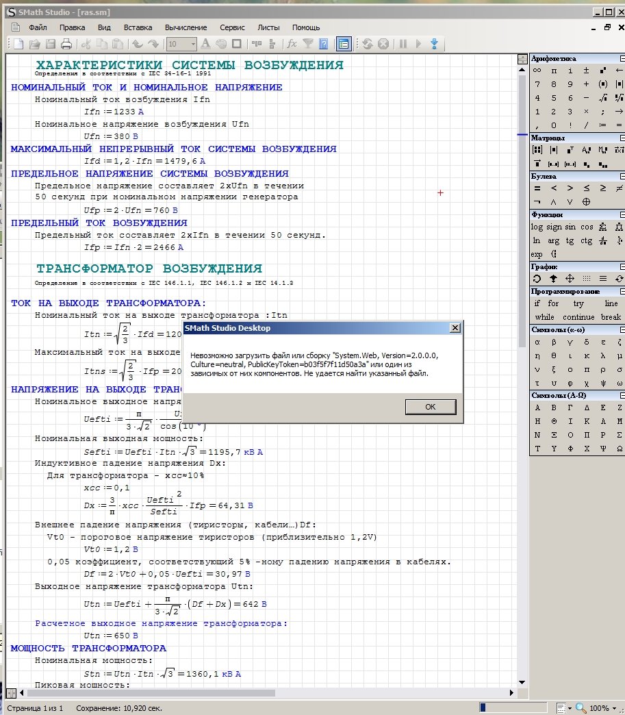

при єкспорте в формат odt выдает ошибку

I'm unable to reproduce. Can you attach the file that cannot be saved as odt?

I tried SS 0.99.6962 and 0.99.6970 with different localization options and I can save without errors. Please post even the error message when you can (with the stack trace, if any). Anyone else notice issues?
Нужно указать больше информации об окружении: версия Windows, версия SMath Studio (+разрядность), версия используемого плагина (Data Exchange). Трудно без этой информации воспроизвести и решить проблему. Мне тоже не удалось её повторить.

It is possible that you don't have .NET 2.0/3.5 installed or enabled on your system (System.Web isn't available in .NET framework 4+ AFAIK). Please download the development tools plugin and then from "Insert > Development tools > System informations" paste the data here.

Windows 7
SMath Studio Desktop 64 бит. ver. 0.99 сборка 6977
Data Exchange 1.1.6858.3747
NET framework 4 is installed on the system
In mine too; but what about previous versions?
CLR 4.0.30319.42000
	installed versions:
	v2.0.50727	2.0.50727.4927 SP2
	v3.0	3.0.30729.4926 SP2
	v3.5	3.5.30729.4926 SP1
	v4
		Client	4.7.03056
		Full	4.7.03056
	v4.0
		Client	4.0.0.0
#13 Опубликовано: 07.02.2019 09:01:15
Андрій
Андрій
