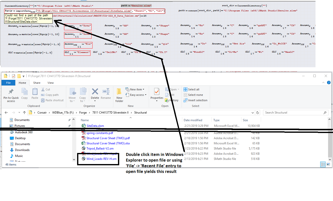

Yes, I probably have that spreadsheet open as I am working. I did not think it was an issue. I will try it with it closed.
If I do not explicitly define the filenames, then when I copy the files as templates, SMATH seems to remember the origins and relative paths from the origin. So the 'child' SMath sheet finds the 'parent' SiteData spreadsheet.
The referenced include statement, which is obscured in my original post, is pointing back to the 'parent' location of the templates too. Perhaps that is part of the issue?

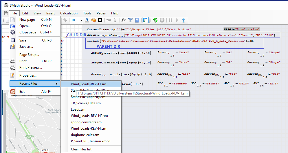

Even if I open it from the File Menu -> Recent Files -> entry, it opens with the wrong CurrentDirectory().

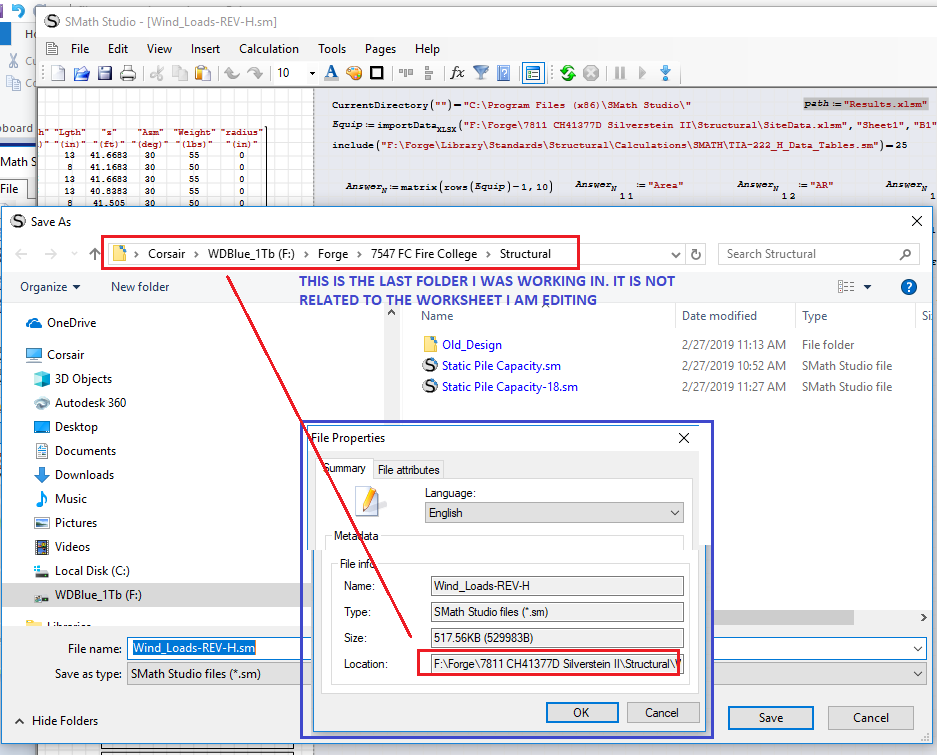

Then when I go to save it, SMath seems to remember the last directory that I was working in.

See screens below.

The problem with built-in importData and maybe some plugins is that if you are using relative paths and they rely directly on the framework functions, these are using the "Current Directory" to resolve relative paths. XLSX import/export, DataExchange, WriterRegion, are "aware" of this potential issue and for relative paths they rebuild a rooted path internally.
The parent location was pointed because you started your smath session there, then you opened the child in the same session (it is a bug, not your fault).
