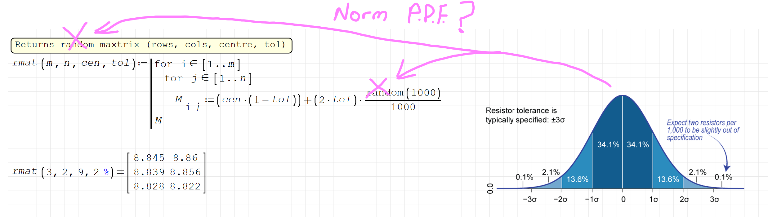

This matrix generator (thanks gUrrozEN) produces random 'equal-probability' values for a given center value and tolerance band.
I'm hoping to revise this to return values within a normal/Gaussian probability as illustrated:
Random to Normal.sm (42,72 КиБ) скачан 1307 раз(а).
Any thoughts?

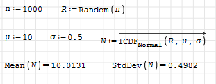

Hi. For 'convert' random uniform distributed numbers between 0 and 1 to another probability distribution, in your case, for get some normal distributed numbers you can use the inverses of the cdf distributions. You can check that here for 1000 numbers you have the desired mean and std deviation
so, I guess that in your function rmat this is the function for normal distributed numbers
random to nomral.sm (5,54 КиБ) скачан 1343 раз(а).

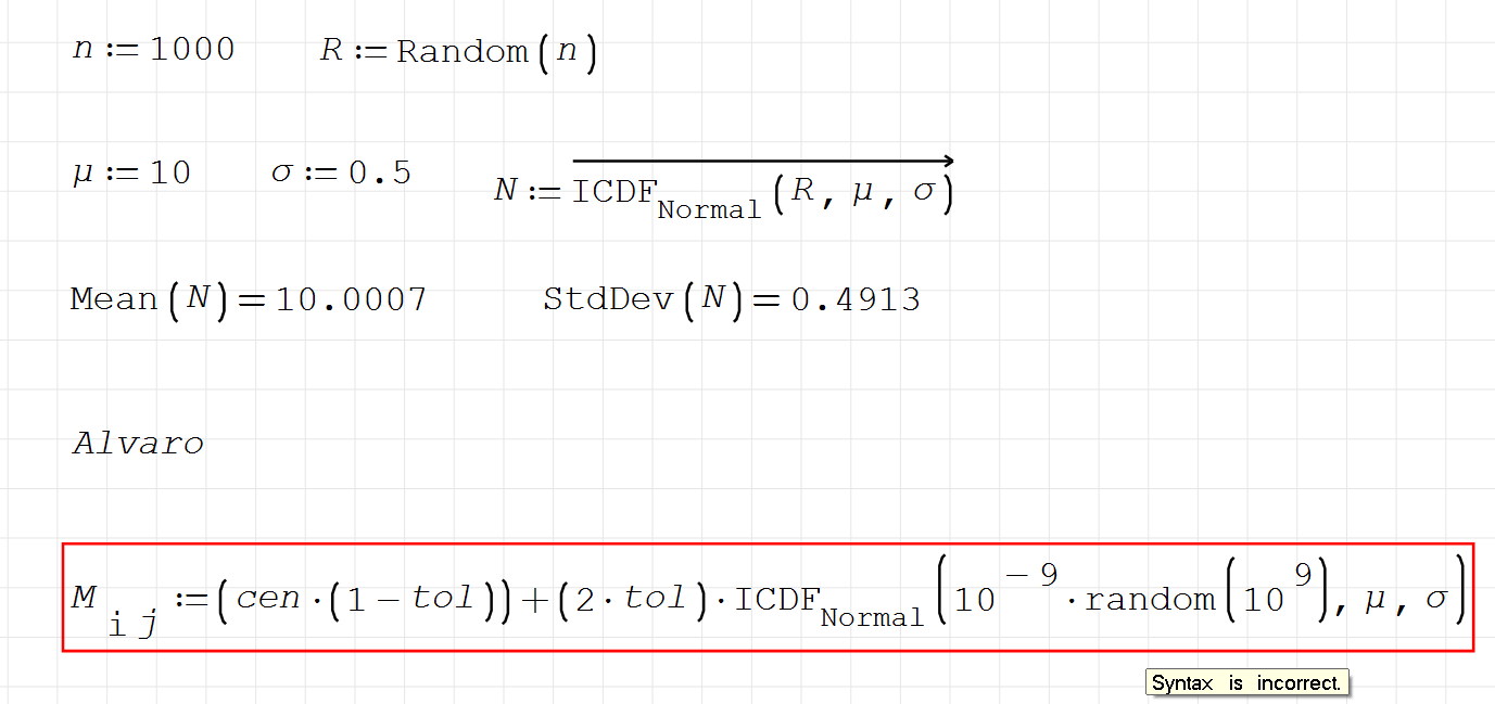

For me, the sample file has a problem:
#6 Опубликовано: 07.01.2023 05:55:38
Hi. I mean: substitute that M[i,j] into your rmat(...) function for get normal distributed numbers with the rmat algorithm instad uniform distributed ones.

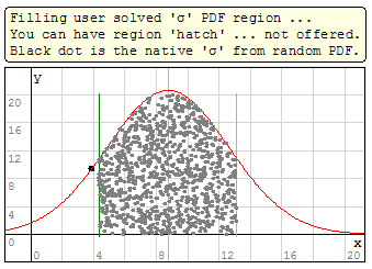

Thank you for the reply Jean.
I'm after a method or function that will return a random value with the probability that 68.2% of the time it will be within 1 sigma, and 95.4% of the time it will be within 2 sigmas, etc.
I don't understand completely ... sorry.
However, from a native random sigma, you can solve for a desired other one.
Cheers, be good Down Under ... Jean.
Random NORMAL Histogram Copy.sm (44,16 КиБ) скачан 1280 раз(а).

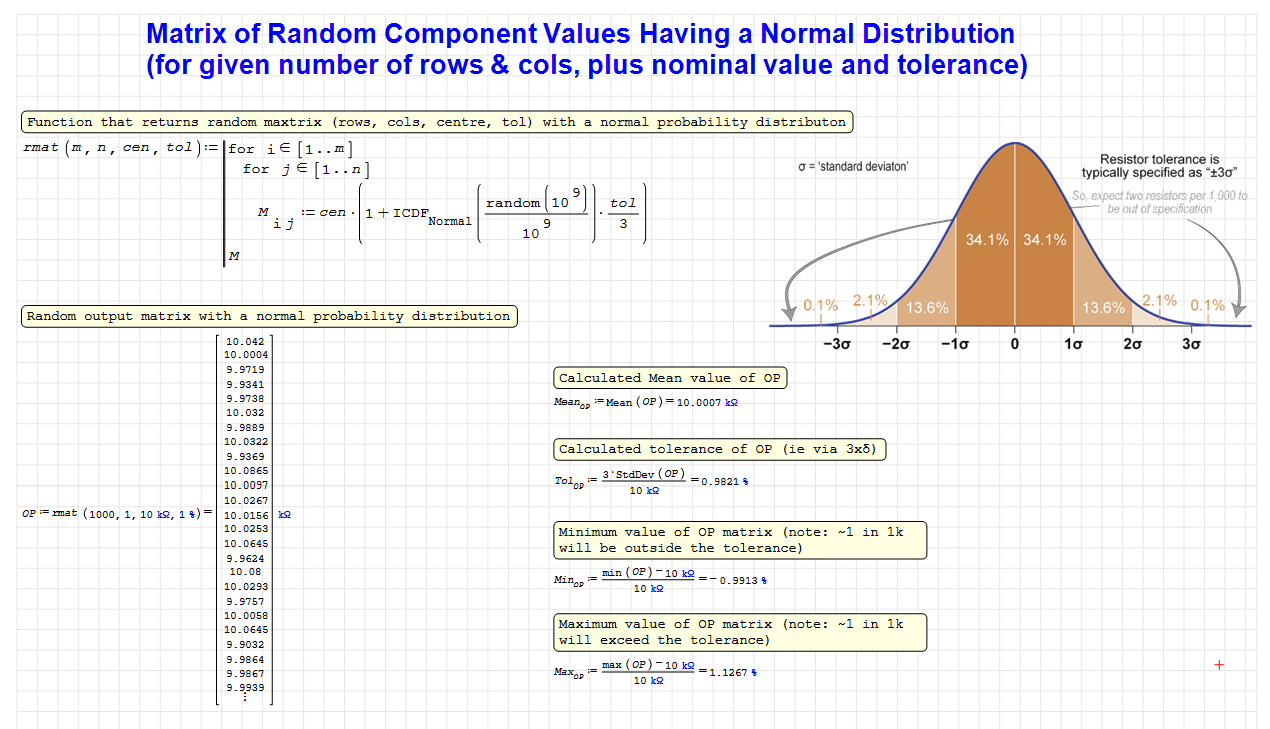

Thank you both. Alvaro: perfect, thank you.
Here is the working update:
20230109 Random to Normal.sm (54,5 КиБ) скачан 1371 раз(а).
