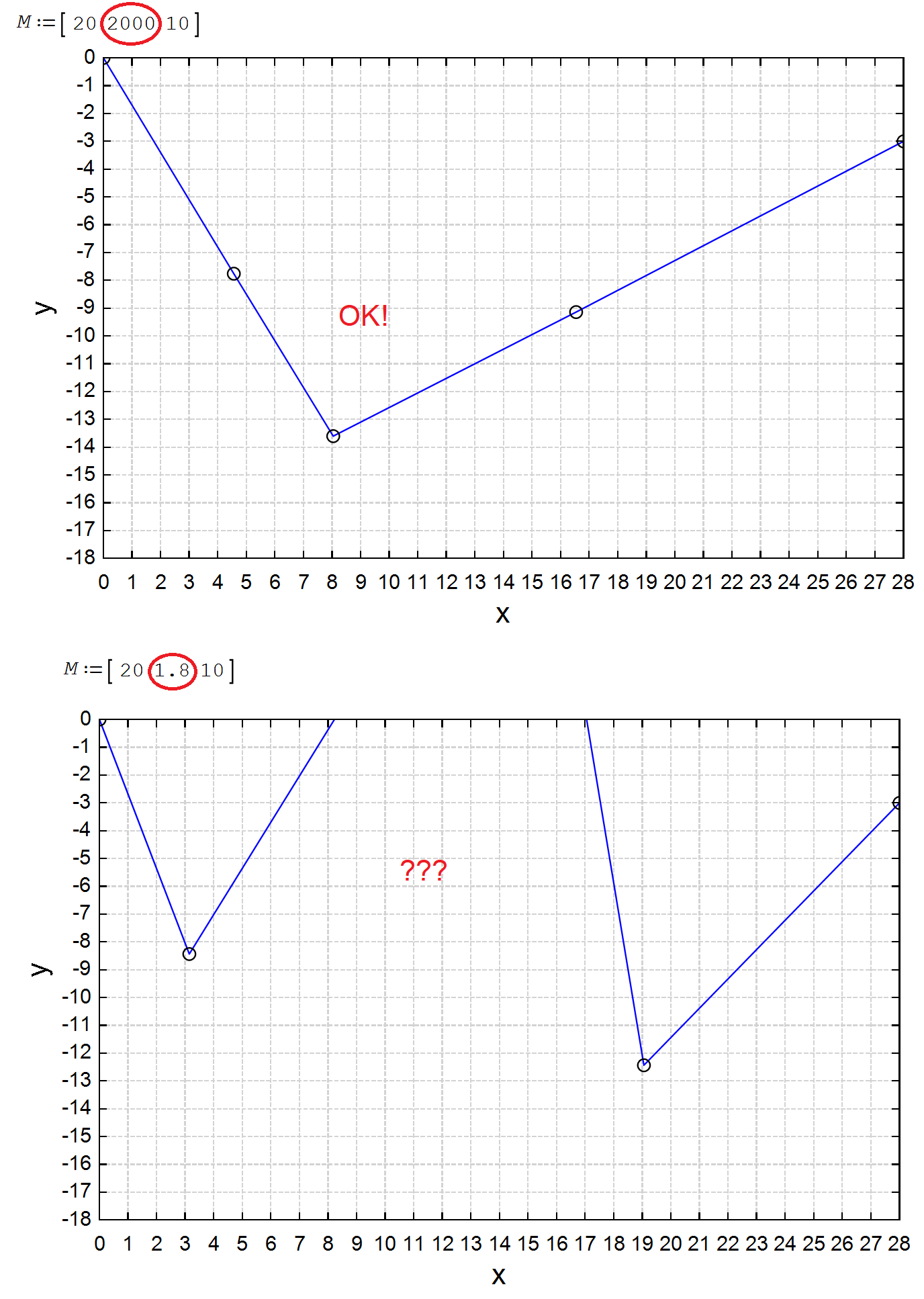

#4 Опубликовано: 09.04.2024 14:52:23
Valery Ochkov
Valery Ochkov
66 сообщений из 690 понравились пользователям.
#5 Опубликовано: 09.04.2024 16:25:15
StvMath
StvMath
44 сообщений из 71 понравились и 1 не понравились пользователям.
Posted
Yes. In the loop where it checks for unacceptable y2 values I should have added the line, msg:="Unacceptable y2 values. Try different initial guesses".
Additionally, by changing lambda = lambda/2 to lambda = -lambda, it seems to work ok!
If you change the initial guess for y2 to 11.5 it also works ok.
Note: The method is very crude. It won't work for more than three weights, for example, without significant modification.
