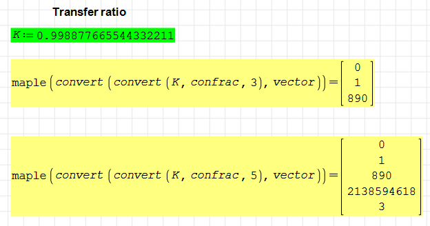

Has anyone made a function in Smath for factoring a number into a continued fraction, similar to making the symbolic function K confrac in MathCad?! Where K represents a fractional decimal number, as in the example in the attached image.

Here is a sample for your question.
confrac.sm (18,73 КиБ) скачан 1428 раз(а).

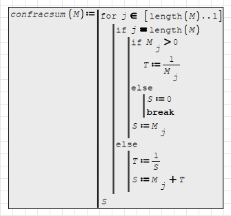

Below is a function to sum matrix of confrac().
ioan92 10.12.2023 18:45:00

Thank you very much for the answer. I arrived at a very similar relation, but which did not work because I omitted to declare the function variable at the beginning of the program in the right member of the definition relation. Using MathCad quite often (where the variable / variables of the function are automatically declared only by mentioning them in the left member of the definition relation) I tend to apply the same rules in Smath. Thank you again.
Greetings.

@uni: The advantage of the relationship is that it takes up little space in the worksheet. The disadvantage of designing such a relationship is that the component functions (convert, confrac, vector) are not predefined anywhere in the program's toolbars (at least not in the version I have). Maybe in newer versions there are predefined functions for these functions.
@Jean Giraud: As a former engineer (currently retired), I base it on practice, simplicity and efficiency. Therefore, in my applications, I don't need anything else than a vector of the decomposition of a decimal fraction into a continued fraction. I used this function (confrac) to calculate the number of teeth of several pairs of gear wheels, in order to obtain a certain transfer ratio K.
