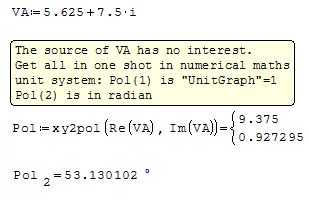

Jean,
In your example:
The Magnitude (length) and The Angle (angle) in polar coordinates have different units. The rad is not a common unit. It is not correct.
In my example:
Look again please:

Better be in harmony wth the maths and Smath.
There is nothing to look gain, Smath is OK.
For sure they have different units: one is in "UnitGraph" the other is in "rad"
YES: rad is correct, rad is the maths unit in trig approximations as well as in official tables.
If you want °: convert by appending ° in the Smath result

Jean,
1.
Please go previously and see the picture.
"rad" is the unit for both the magnitude and angle.
There is ONE placeholder for ONE unit.
YES: rad is correct, [YOU JUST SAID THAT ONE IS LENGTH THE OTHER ANGLE!!!] rad is the maths unit in trig approximations as well as in official tables.
2.
In this specific set of applications I have no interest in "numerical MathEMATICS". I use units. Thank you.

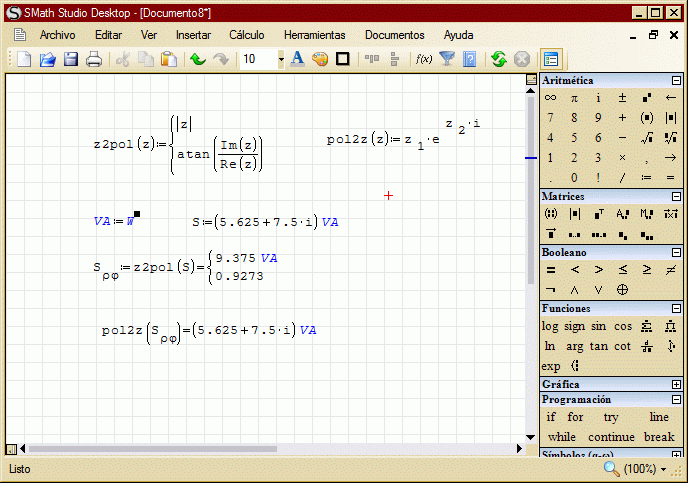

Mike,
The xy2pol does not work when units are included:
Do we agree?

WroteMike,
Do we agree?
Yes we do
ЦитатаWhen eventually it is working:
The units of the "Magnitude" and the units of the angle, (for the case of complex numbers here), will be different.
Yes, that's what I show in my screenshot, that uses ≡ instead of =, just to show the desired result: seeing is better than reading.
ЦитатаNote: I see you got W(att) how?
Now I suppose it's apparent: Ctrl+= and manually make system with desired result
ЦитатаI see that you have a semicolon ( ; ) I have a comma (,).
Re(S);Im(S) versus Re(S),Im(S)
Russian locale default settings

In this specific set of applications I have no interest in "numerical MathEMATICS". [Basile]
From A...Z, Smath is a numerical math tool as any other CAS and including your specific application.
xy2pol result is a vector of two components that need no unit as they are implicit. Extract each
component and append a dead unit decoration for clarity to yourself and the reader.

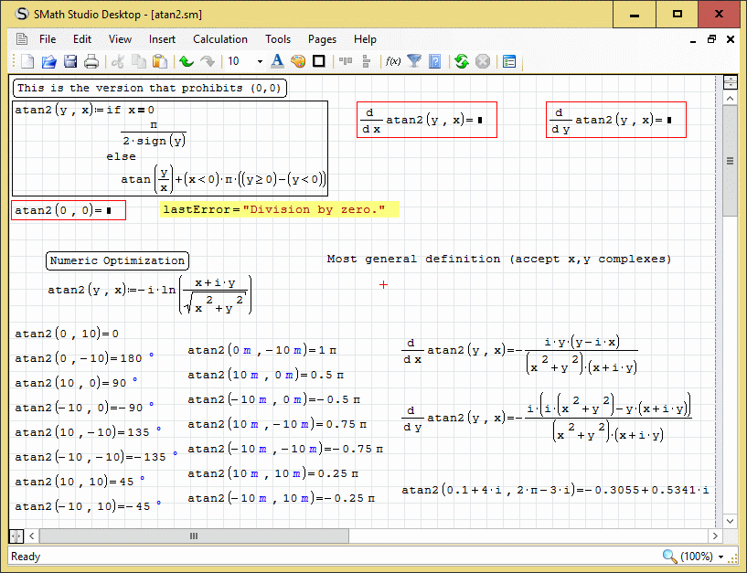

WroteNotice that atan2 ins't in SMath, which is more correct than atan for this functions (see http://www.mathworks.com/help/matlab/ref/atan2.html for example).
atan2.sm (35,42 КиБ) скачан 1274 раз(а).

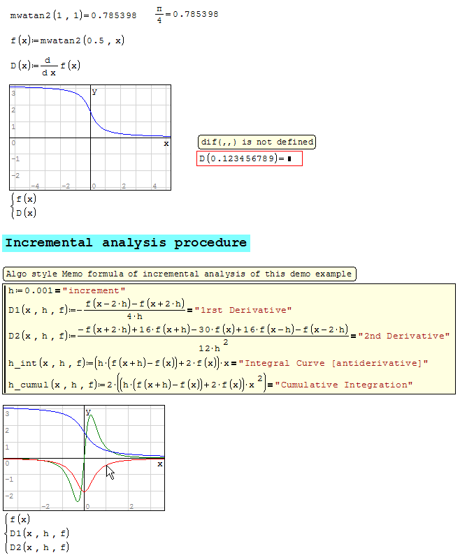

Hi Mike. I prefer this other, but have some round inconvenients:
WroteI guess that with the new try function samebody can make a good one atan2.
But with try, it won't differentiate again.
С уважением,
Михаил Каганский
WroteWroteI guess that with the new try function samebody can make a good one atan2.
Oh, I think that this happen only to me :-). Not very sure that try don't accept diff.
So, this with numerical optimization must to be the best solution (until atan2 not be in SMath):
It's a good option, and only ~30% slower.

Like this Alvaro: look for the Matlb code in the f(x) menu,
look for mwatan2 ... if you have in your version: then go
Maths atan2.sm (10,93 КиБ) скачан 1323 раз(а).
