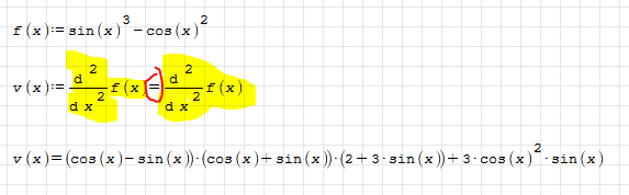

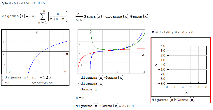

I found small bug in Differential Equations Display.
Simple example:
Calculations are done. But symbolic evaluation do not show the outcome.
The problem is not catastrophic. But I thought it worth it to report it.

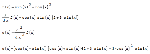

#2 Опубликовано: 16.06.2018 21:59:33
Confirmed: no bug ... your screen is lazy to expand ... if that what you have !

Jean, you misunderstood the "problem".
Not the calculation is wrong.
This is:
As I wrote, it is not big and not a kind it is impossible to live with it.
I am just reporting what I notice.

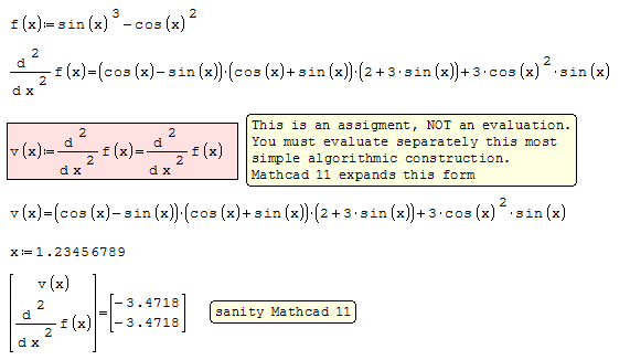

There is no use to evaluate the Mathcad style. On the other hand,
many direct expansion Mathcad style can't be copied for export.
Thus, the best is the algorithmic construction. On that point,
Smath is fully competent ... look @ the "Colibri" attached.

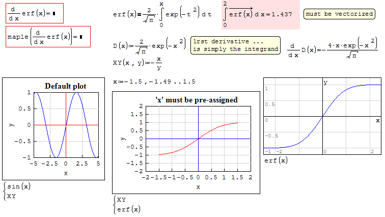

There are few more curiosities in Smath.
In Smath, erf(x) is not a scalar function in the maths sense,
Build the example
and if you get the two red ones, "X-not defined"
that you must read "erf(x) is not scalar" ... Thus:
1. vectorize the integrand
2. Pre-assign the X_Y plot
Example from version 6179

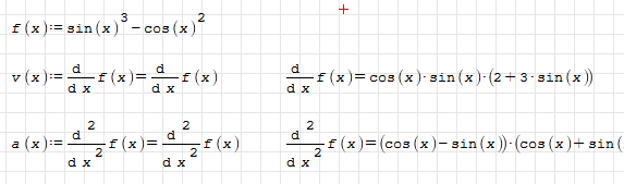

Thank you, [USERLINK]PDG[/USERLINK].
Bug confirmed. Will look at it later.

#8 Опубликовано: 17.06.2018 20:31:41
That one, X_Y refuses plotting at all !
#9 Опубликовано: 17.06.2018 23:23:28
I accept, but in turn you must accept the fundamental
concept of transit algorithm in integration/derivation.
Good thing it is this way, otherwise lot more advanced maths
could not be done or would issue errors messages of all kinds.
... light red page 4.
Maths_0 Transit [The concept].sm (76,77 КиБ) скачан 1112 раз(а).

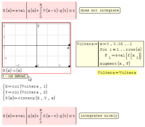

#11 Опубликовано: 18.06.2018 00:32:23
... this is another style of parametric solution.
... a much different style of transit.
At that times my brain diluted on that one !
Takes quite a while before "t_not defined"
Integrate Voltera IntEQUATION.sm (28,22 КиБ) скачан 1348 раз(а).
