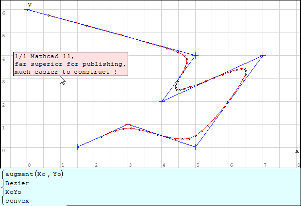

#12 Опубликовано: 26.10.2017 10:52:56
... Mathcad 11 can't do the very same, superb for publishing.
